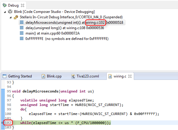

    I am trying to reproduce this.  I am using the blink example as it has a loop in it.  Are you seeing a mismatch between the items in red below or a mismatch between the items in red and where the PC is actually shown?  Or a mismatch between the items in red, the location of the PC arrow and the actual location of the PC?
  • One thing to take a look at is the Disassembly View.  That will show both the assembly statement CCS has halted at as well as the source line that it feels it is associated with.  I have seen some strange things where because of pipelining part of the next instruction (fetch) has started and hence the source assocation shows that the next line of source has been executed when really you are still on the previous line.

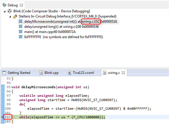

  • I've attached a simple zipped project that exploits Energia's broken readBytesUntil to hang reliably-- send it anything on serial at all and it'll hang at the same place. See also my attached screenshots of the debugger to see what I mean-- the line numbers agree with each other but are both wrong.
    Also, I believe the last shot shows that line 362 has not yet been executed-- otherwise the mouse-over view of cChar would show its current value. Additionally, the disassembly appears to show the wrong line.
    Don't set any breakpoints in this project; just send something and then pause. If you breakpoint inside HardwareSerial.cpp and single-step, it won't have any issues and the line numbers will be correct. The issues only happen when something goes wrong.

  • The "should_be_239" and "should_be_35" captures look like a bug.  The "should_be_362" looks right given the instruction that is shown to be executing in the disassembly view.
    Basically for anything in a previous stack frame it looks like it is off by one.
    I will reproduce this and file a bug against the debugger in CCS.

  • We have been having a lot of discussion with the debugger team on this one after filing the defect.
    What you are seeing in CCS is intentional.  Basically it is showing where it is going to return to vs where it entered the next frame.  The reason for this is that when optimization is on you may have a() calling b() calling c() but the call frame is setup so that c() returns directly to a().
    Anyway it doesn't look as straight forward as we thought.  Some compilers have extra debug info generated that helps figure things.
    We are still talking about this one but I thought I should give you an update.
