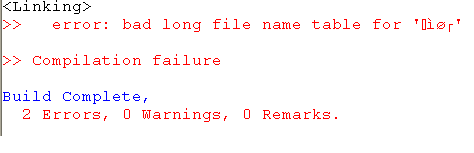

Hello, I'm beginner in Code Composer Studio and I want to add a library of image processing SDL but I can't, help me please.

    The problem is that the SDL libraries exist only with the extension .al and .a
    I added the library but the error persists.
  • What error message are your seeing?
  • Here are the errors displayed:

    >>   error: symbol referencing errors - './Debug/test1.out' not built
    >> Compilation failure

  • If I add the library "libSDL.la"  error becomes:
    [Linking...] "C:\CCStudio_v3.1\c6000\cgtools\bin\cl6x" -@"Debug.lkf"
    <Linking>
    >> C:\CCStudio_v3.1\c6000\dsk6713\lib\libSDL.la, line 1:   error:
                   illegal input character: hex 23
    >> libSDL.la:   error: system error, can't open file 'libSDL.la' for input: No
                           such file or directory
    >> Compilation failure
    Build Complete,
      3 Errors, 0 Warnings, 0 Remarks.
    Thanks.
  • CCS does not seem to automatically recognize *.al as a library if you just add the file to the project. But *.a is recognized. So you may need to explicitly reference it in the Build Properties under the linker "File Search Paths" (--library, -l). That should work

    I added the libraries correctly, but a strange error appeared:
    I apologize for the inconvenience
