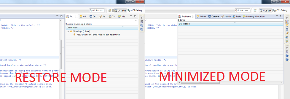

I have my problems view in the minimized mode, i.e. it only pops out if there are errors after a build or I click on the icon in the side tray (see screenshot)
I just noticed that if I have focus on a project file in the C/C++ editor instead of the project explorer, then all errors and warnings disappear from the view!
If I select focus on the same file in the project explorer view they all reappear again.
This doesn't happen when the problems view is in the restore mode (i.e. permanently popped out). subsequently I'm not sure when this started happening as I had it in restore mode since I installed CCS v6.1 until about two days ago.
In the problems view menu->show I have made sure both "Errors/Warning on project" (why are there two?) are selected.
EDIT: I just found that if I selected "Show all" in the problems view menu->show then everything works, but if I have more than one project open in CCS this will begin to get confusing pretty fast as I'm assuming it then includes all warnings and errors from ALL projects...
