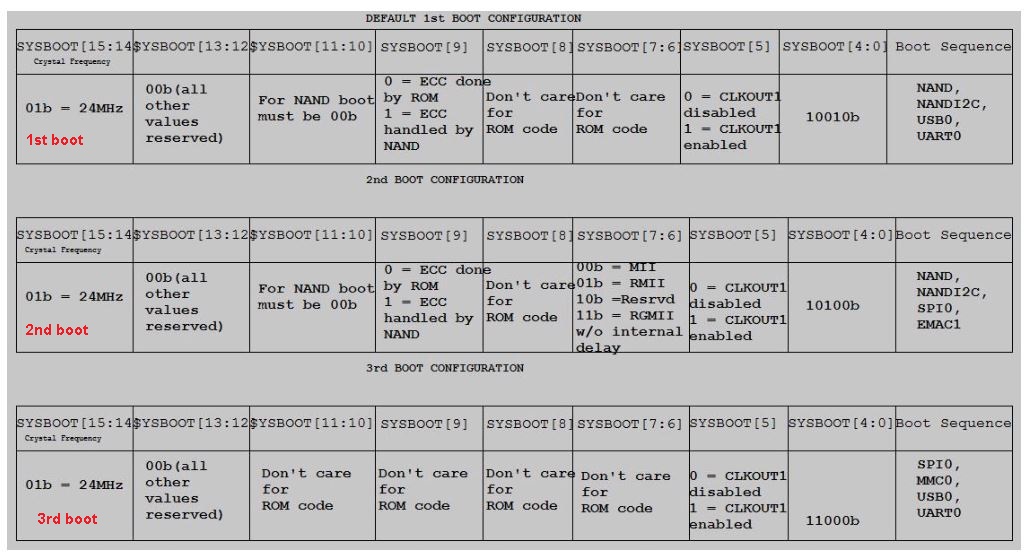

I am trying to load a boot loader to NAND flash using CCS V6.0 and XDS200 usb emulator . I am following below steps to flash boot loader to nand flash .

This is working only if  boot configuration doesn't have NAND boot in its boot order  or NAND flash is empty . Connect to target failed with following error when NAND flash contains a valid boot loader .

CortxA8: Trouble Writing Memory Block at 0x4c0000e4 on Page 0 of Length 0x4: (Error -1065 @ 0x3D5A) Unable to access device memory. Verify that the memory address is in valid memory. If error persists, confirm configuration, power-cycle board, and/or try more reliable JTAG settings (e.g. lower TCLK). (Emulation package 5.1.507.0)
CortxA8: GEL: Error while executing OnTargetConnect(): Target failed to write 0x4C0000E4     at *((unsigned int *) (0x4C000000+0x0E4))=(unsigned int) 0x200006 [AM335x_15x15_EVM_v1_5.gel:261]     at DDR3_EMIF_Config() [AM335x_15x15_EVM_v1_5.gel:350]     at AM335x_EVM_v1_5_Initialization() [AM335x_15x15_EVM_v1_5.gel:335]     at OnTargetConnect() .
In the above boot modes , only 3rd boot mode is working for flashing program to NAND using Xds200 jtag if NAND flash contain a valid program.
So if  NAND flash once loaded with a valid program , I am unable to overwrite existing program using XDS200 jtag connection . I need to change boot configuration to boot from UART  for doing the same . OR I have to erase complete NAND flash .
But this is not possible always .
Can any one suggest exact issue ?
