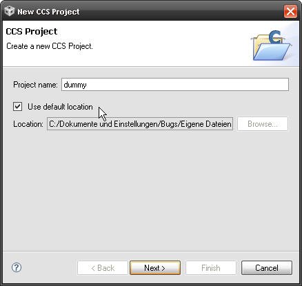

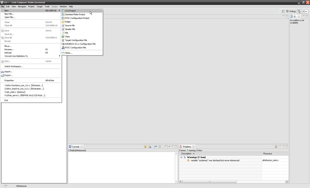

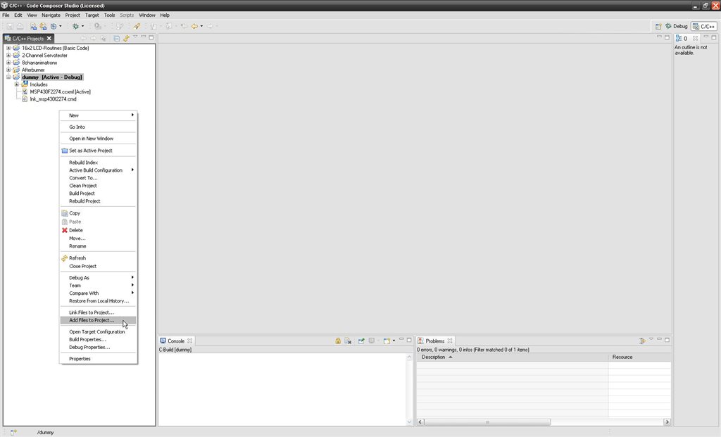

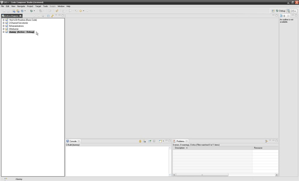

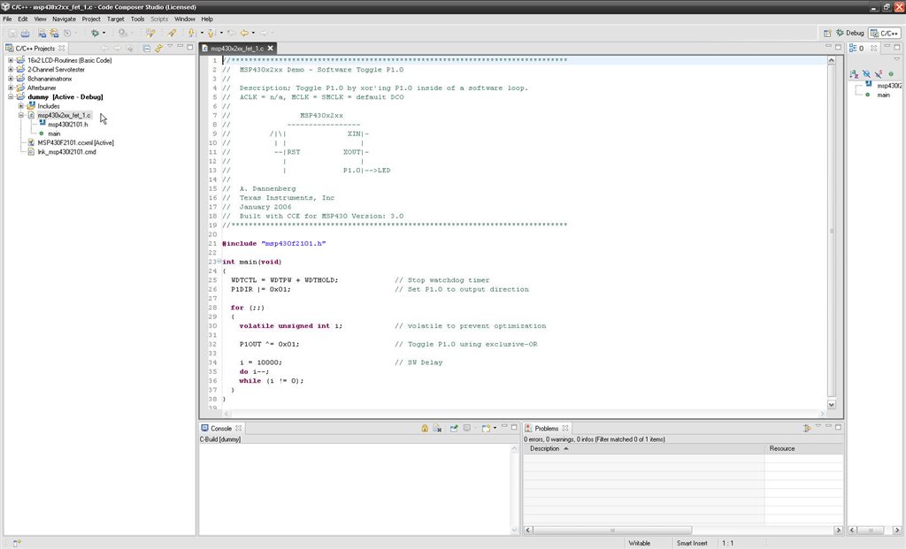

  • Hi Christopher,
    I took the time for making some screenshots (and a simple 'how to' in text).
    1.) Open CCS (which version are you using?)
    2.) to make a new project from scratch click on FILE-->NEW-->and select CCS PROJECT
    3.) Give your project a name and choose the location were to create it. Default location is in 'user files'--> folder workspace. CCS will create a new folder there with the name of your project
    4.) You will have to select the target (I used MSP430F2101 for the example). Now a new project shows up and CCS sets this new project as active
    5.) Since you may have some sources/headers already you now place the cursor in the window were the project trees are and click right. A context menu shows up which looks like this
    6.) Click on 'ADD FILES TO PROJECT' - a browser window opens and you can brose to the location or your files and add them to the project. CCS will copy the selected files into your project folder. You want to have the HIGH-END, FULL FEATURED BLINKING LED example source code to be added. Do to sow, browse to PROGRAMS-TEXAS INSTRUMENTS-ccsv4-msp430-examples-msp430x2xx-C-source-and select the file you will find there. CCS now copies it to your project folder (check it out).
    Double click on the file and now your workspace should look like below.
    7.) Now you're ready to start debugging. Connect your target, click on the 'launch debug' button and here we go.
    I hope this helps, rgds

    Add files copies files into your project folder "link" files creates a reference, i.e. they are part of your project but it leaves them where they are.  A project assumes that it is going to have 1 output (.out or .lib).  Thus if you want to build your library and link it as part of the project then you should create a project for the library and then one for the application that is linking it and set up the library project as a referenced project, when you build your application it will build the library project if needed as well.  That also makes it easier if you want to reuse the library across multiple projects.  Now if the library is already built and not getting rebuilt you can just go into your project options for the linker and add it and then it will just get linked when the linker runs.
    John

  • "Add files to project" and "link files to project" just control how a file is added to the project.  Add files makes a copy in the project directory, link files just makes an entry in one of the project files.  In the link case the file is not physically in your project directory.
    The behavior for C files versus H files can be a bit confusing.  When you add or link a C file it will automatically be built it is the project system that passes the files to the compiler.  H files on the other hand are not passed to the compiler they are referenced by other source files so the compiler needs to know where to find them.  Adding or linking a H file to your project does not update the include search paths that is something you need to do explicitly via the build options.

  • This answer is a pretty good answer. It is ill advised to add files to the  "Includes" folder. This will make it alot more difficult for users to identify source files when they look at your code.  You are however an intelligent engineer and its totally up to you how you organize your code. Additionally I think the introduction of Control suite adds a compelling reason to want to add libraries. You can do it as follows:
    Select the Project you want to add files to:
    Select Project->Properties->C/C++ Build and under "Tool Settings" tab Select "Include options" in the bottom window add the directory path
