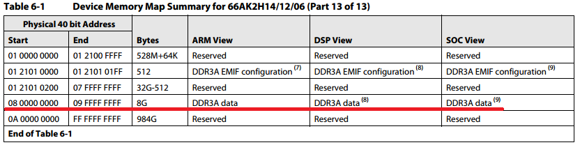

For example, EVMK2H's DDR3A base address is 0x8000_0000 in case of "CPU Memory View"
If I change memory browser setting to "Physical Memory view", memory browser pointed to 0x8_0000_0000 automatically.

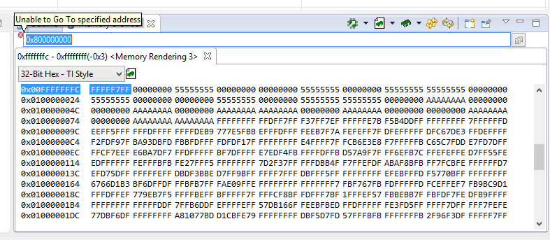

It is operated in the CCSv6.02, but it is not operated in above version as follows.
I need to 40-bit memory browsing using CCSv6.1, I don't think to come back previous CCS version.
There is some extra setting on the CCSv6.1 to enable 40-bit memory browsing?

    We are trying to see if we can reproduce this at our end. In the meantime, would you be able to do one quick test?
    Can you try to access the addresses via the expressions View? This can be done by entering the following expression into the expressions view:
    (*(800000000@PA))
    This bypasses the memory browser and memory map and should help us narrow down the issue.
    Please let us know the results and we will also report back when we have more information.
  • Gilbert,
    This is a regression with CCS. I have created a critical bug report ( SDSCM00052194 ). You can use
    cqweb.ext.ti.com/cqweb;format=HTML&version=cqwj to track the status.
    The only alternatives/workarounds I can suggest for the time being are
    1) To keep using 6.0.2
    2) Use the expressions view. You can enter any address with the @PA annotation to read that address from physical memory.
    i.e (*0x800000000@PA)
