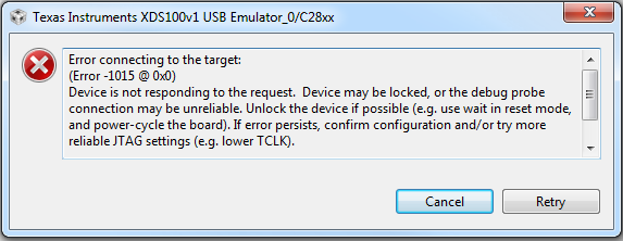

Unable to resolve error "Error connecting to the target: (Error -1135 @ 0x0)"
Other Parts Discussed in Thread: CCSTUDIO, TMS320F28035, CONTROLSUITE
I'm using the TI resolver kit. I'm trying to run Resolver-DevInit_F2803x.c. When I click on the debug button in 5v5 a receive the following error.
(Error -1135 @ 0x0)
The debug probe reported an error. Confirm debug probe configuration and connections, reset the debug probe, and retry the operation.
(Emulation package 6.0.14.5)
Also when I do a Test Connection, I receive the following "failed" message

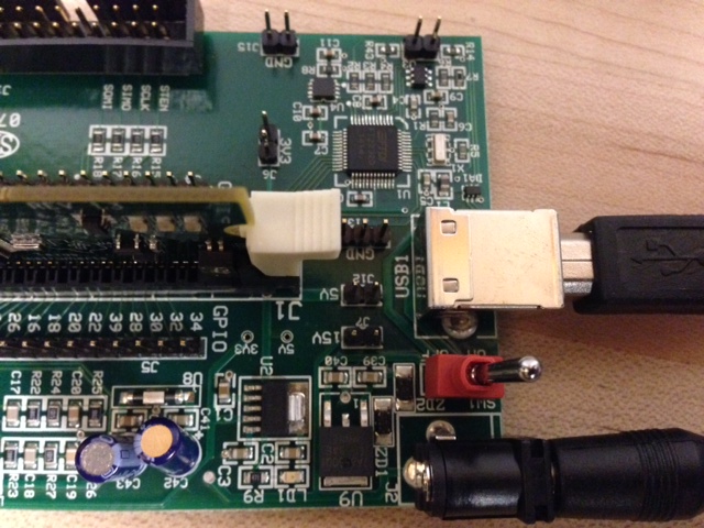

I've checked the following:
-The device shows up in Device manager, so it is connected.
-All voltages on the device are correct.

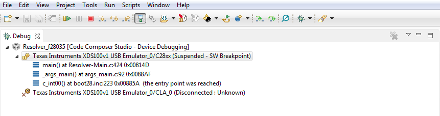

    A brief update on the problem. I'm still having the same problem; however I installed the latest software....v6, and I continue to have the same issue.
    I am reading TMDSRSLVR - Resolver EVM (R2.0) Kit - How to Run Guide, and following these directions.
    For a Target Configuration it asks that the connection be "Texas Instruments XDS100v1 USB Emulator". I cannot find this connection choice. I think that this may be part of the problem. Again this problem occurs if I use V5 or V6. I cannot find this connection in either version
    Again...any help would be appreciated.

  • Below is the screen shot I meant to post:
  • I'm having trouble posting a screen capture like you did. What is the trick to this? I'll try one more time...

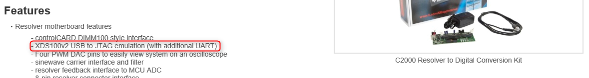

  • James,
    Unfortunately I don't have this development kit. Also, since the images did not go through, I am not sure what the guide says, but if it says XDS100v1, it does not match what is mentioned on the product description:
    If the description is correct, please select XDS100v2 instead.
    The difference between what the guide says ("Emulator") and Gautam's screenshot ("Debug Probe") is just cosmetic. It was a difference done in the latest releases of a CCS component designed to correct a misnomer originated almost two decades ago.
    Hope this helps,
    Rafael

  • Sorry for being out of loop due to weekend. Yes the resolver kit has a XDS100v2 as its on-board emulator. I hope you've taken care of all jumper settings?
  • James,
    I now have access to a computer with controlSUITE installed, and looking at the schematics for the TMDSRSLVR kit I can tell it is, in fact, a XDS100v1 (it uses a FT2232D device instead of the FT2232H of a XDS100v2). Thus the page description is wrong.
    James McCullagh said:
    -Piccolo TMS320F28035Isolated controlCARD
    That detail actually brought me a recollection of a similar issue I had a few months ago: some isolated controlCARDs do not have JTAG signals routed to the DIMM connector. Thus, looking at the F28035 isolated controlCARD schematics, you can tell this is the case for this board.
    In this case, you should connect the USB directly to the JTAG port of the controlCARD and power it through the 15V jack as well.
    From your description I wasn't sure you already tried that.
    Hope this helps,
    Rafael

    To help I am attaching pictures of the board. Maybe you guys can see something I don't....

  • James,
    Thanks for sending the pictures. Perhaps I was not clear on my previous explanation, but can you disconnect the USB cable from the "USB1" connector on the base board and connect a USB cable to the USB-mini connector on the controlCARD itself? This is the mini USB connector at the left of your last picture, which should be marked as "J1" (at least according to the schematics I have here).
    The message you are seeing does not influence the ability to connect at all. It could potentially create different .out executables (given the differences in the compiler versions). If you are interested in installing the previous compiler release, please check sections 2.2 and 3 of the page below:

    Yes...that helped, and it definitely solves part of the problem. The mini-USB connector did not come with the kit. However, when I found and used a mini USB connector connected it to "J1", additional lights turned on and I am getting a different error when I push the "Test Connection" button. This new error is more specific, and it will hopefully be easier to debug. It is below....

  • James,
    Unfortunately no. The error you are getting now is related to the fact the PC can't recognize the JTAG debugger at all - before it was able to recognize it, but it was not able to talk to the device (which is consistent with the explanation I gave you on a past post).
    At this point, I can only ask you to double-check the Windows Control Panel and see if there is an instance of the XDS100 there - something shown in section 2.6 of the XDS100 wiki page.
    If that does not show up, double-check the USB cable you are using: either if it is broken, loose or is a charger-only cable (no data, only 5V power). I fell on the trap of using these charger-only cables several times already...
    Also, just to double check the connections, you should have something similar to what is shown on the screenshot below:
    Don't forget to put the switch SW1 to the ON position, so the processor and the resolver board are properly powered.
    Apart from that, I really don't know what else could be going wrong in this case.

    OK, it may have been a loose cable. I wiggled it, and it showed up on the device manager. It was an older cable I found lying around in the lab. I ordered another.
    The setup now looks as follows. Before the light on the top left by the mini-USB was not on. Now it is. That seems like a step in the right direction.
    The good news (I think) is that I now get a new error when I push the debug button. I see the following:
    When I do "Test Connection" I get a similar readout. It is below:
    It is surely progress, given the PC is able to communicate with the XDS100 debugger.
    However, there is still a problem between the XDS100 and the device. Before trying to analyze the issue at a lower level, can you set SW2 on your controlCARD to different settings and see if you are able to connect to the device? This way you may prevent code that was previously loaded from running and therefore influencing the ability to connect to the JTAG.
    Also, can you double-check SW3 position? According to the controlCARD infosheet, it should be in the ON position for JTAG to communicate.
    If none of this works it may be a hardware problem. It seems that part of the circuit is somehow powered down, one of the ICs or Isolators is failing or a JTAG line is shorted to Vcc, as the Test connection utility reports that it sent all ones (0xFFFFFFFF) through the JTAG TDI pin but received all zeros (0x00000000) on the TDO pin as a response.
    That will require you to pull your DMM out and check voltages around the controlCARD, or ultimately repair/return it.
    Hope this helps,
    Rafael

    Your screenshot shows a successfully connected target, with code and symbols loaded, and the processor is halted at main().
    The details about the switches are shown in the board infosheet I have (supplied with controlSUITE and I send it attached below). It seems the switch designators are reversed in your board, but that shouldn't matter much.
    From there you can tell that SW3 (SW2 in your board) completely disables JTAG, therefore it explains the total inoperative status when this switch is OFF.
    Regarding SW2 (SW3 in your board), they define how the processor will boot when brought up from reset - if code is preloaded on the device, the status of the LEDs will be tied to what this code does. From your experiments you can tell the LED behavior is the same irrespective of SW3 (SW2 in your board).
    At last, once you have a proper debug session running, the "Test Connection" button ceases to work - basically the JTAG debugger is "locked" by the Debug Server system on CCS and no other process on your computer can access it.
