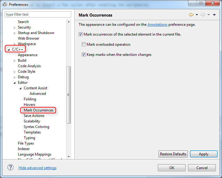

  • Stephen,
    If you go to Window -> preferences.  Click on show advanced options at the bottom then the option is shown in this capture.  However I don't see anything that changes this particular behavior.  It seems to just turn the whole thing on or off.
    For me I do see the members being highlighted in 6.1.1.
    John
