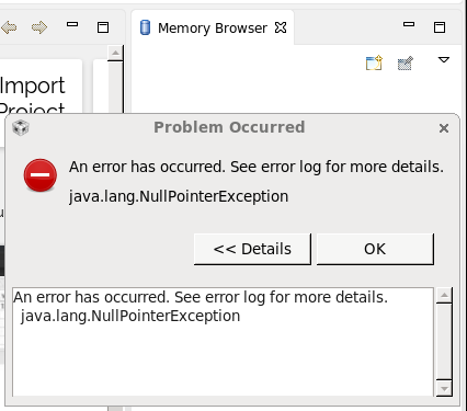

CCS 6.1.1 Memory Browser can open without all toolbar options
When using CCS 6.1.1.00022 under Linux to debug a Cortex-A8, found that the Memory Browser was sometimes being opened without all of the CCS specific options in it's toolbar.
The steps to re-create, without having to actually debug a target are:
1) Create a new workspace.
2) Open the CCS Debug perspective.
3) Open the Memory Browser view. A "Problem Occurred" dialog is displayed reporting a java.lang.NullPointerException. The Memory Browser is displayed, but it's toolbar only has "Open New View" and "Pin to debug context" buttons:
The Eclipse log file has the following stack backtrace for a NullPointerException in the MemoryViewDecorator.java source file:
!ENTRY org.eclipse.ui.workbench 4 2 2015-11-06 10:49:29.372
!MESSAGE Problems occurred when invoking code from plug-in: "org.eclipse.ui.workbench".
!STACK 0
	at com.ti.ccstudio.debug.internal.ui.memory.MemoryViewDecorator.handlePartOpened(MemoryViewDecorator.java:122)

4) Close the Memory Browser. Another "Problem Occurred" dialog is displayed reporting a java.lang.NullPointerException is displayed. The Eclipse log has another stack backtrace for a NullPointerException in the Memory Browser related Java source code:

5) When I was using the CCS 6.1.1 Memory Browser to debug an actual Cortex-A8, I could get the full CCS Memory Browser toolbar back after combinations of restarting CCS and/or closing and then re-opening the Memory Browser. But with the empty workspace I haven't been able to make CCS 6.1.1 display the Memory Browser with the full toolbar.
I also haven't been able to repeat the failure with CCS 6.1.0.00104, which displays the Memory Browser  will the full toolbar even with an empty workspace:
  • Hi Chester,
    Thanks, I can reproduce this. If you don't have a debug session running, opening the Memory view will generate that error (and have items missing from the toolbar). I filed a bug for this, tracking ID: SDSCM00052465
    ki
    OK, I can see that now. If the Memory view is opened where there is no debug session running then the items are missing from the toolbar. Once in that state, the workaround is to close and then re-open the Memory view once a debug session is running (and all the items are then in the toolbar).
