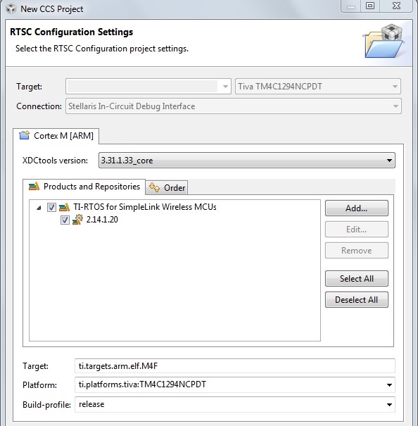

   I installed TI-RTOS for Tiva C. After that there is no selection for TI-RTOS for TivaC when creating a new CCS project. See, below. I think there should be a selection for TI-RTOS for TivaC since I installed it from CCS App Center.

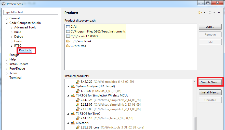

    It looks like it was not detected by CCS. If you installed from App Center, it usually ends up inside your <CCS INSTALL DIR> and should be autodetected. Try forcing CCS to detect new products via the preferences (Window -> Preferences):
    ki
  • What I did was install the TI-RTOS windows installer at my CCSV6 installation directory. Then I thought I should follow the guide so I Installed the TI-RTOS for TivaC from CCS App Center, and this is what happened. I will try your advise and report back.

    I can see the TI-RTOS for Tiva C now. Thanks.
