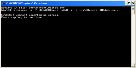

Step 3:  Run BH diagnostic BHreset_560.bat.

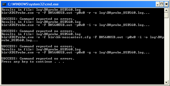

Step 4: Run BHprobe_560.bat

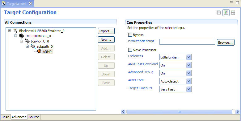

Step 5:  Configure CCS 4.1.2 for this setup.

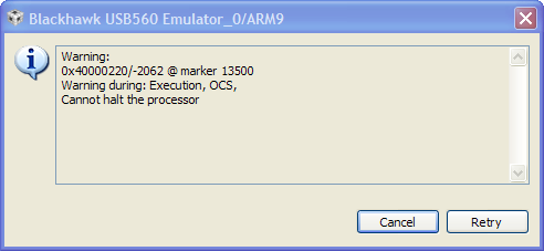

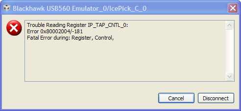

Step 6: Launch Debug session and connect.  Two error boxes appear:

Step 8:  Try BHreset_560.bat again:
BHreset_USB560.log said:
  BHProbe 5.01: Blackhawk USB560 JTAG Emulator
Wed 05/12/2010-15:21:17.45
bin\XDSProbe.exe -v -F BH560USB.out -p0x0 -r -o log\BHreset_USB560.log
-----[Print the reset-command software log-file]-----------------------------
This utility has selected an XDS560 class product.
This utility will load the program 'BH560USB.out'.
This utility will operate on port address '0'.
The controller does use a programmable FPGA.
The old VHDL code has a version number of '1544' (0x0608).
The new VHDL code has a version number of '1544' (0x0608).
An error occurred while hard opening the controller.
-----[An error has occurred and this utility has aborted]--------------------
This error is generated by TI's USCIF driver.
The value is '-181' (0xffffff4b).
The title is 'SC_ERR_CTL_NO_TRG_CLOCK'.
The explanation is:
The controller has detected a dead JTAG clock.
The user must turn-on or connect the JTAG clock for the target.
Done.
Step 9:  Try BHprobe_560.bat again:
BHprobe_USB560.log said:
Wed 05/12/2010-15:22:29.73
TEST 1 - RESET
Wed 05/12/2010-15:22:29.82
bin\XDSProbe.exe -v -F BH560USB.out -p0x0 -r -o log\BHprobe_USB560.log
The explanation is:
Done.
TEST 2 - SCAN
Wed 05/12/2010-15:22:31.76
bin\XDSProbe.exe -v -F BH560USB.out -p0x0 -i -o log\BHprobe_USB560.log
-----[Print the controller-open software log-file]---------------------------
The explanation is:
Done.
TEST 3 - SCAN2
Wed 05/12/2010-15:22:33.68
bin\XDSProbe.exe -v -f bin\bh-noscantest.cfg -F BH560USB.out -p0x0 -i -o log\BHprobe_USB560.log
The explanation is:
Done.
TEST 4 - DATA
Wed 05/12/2010-15:22:35.76
bin\XDSProbe.exe -v -F BH560USB.out -p0x0 -g -o log\BHprobe_USB560.log
The explanation is:
Done.

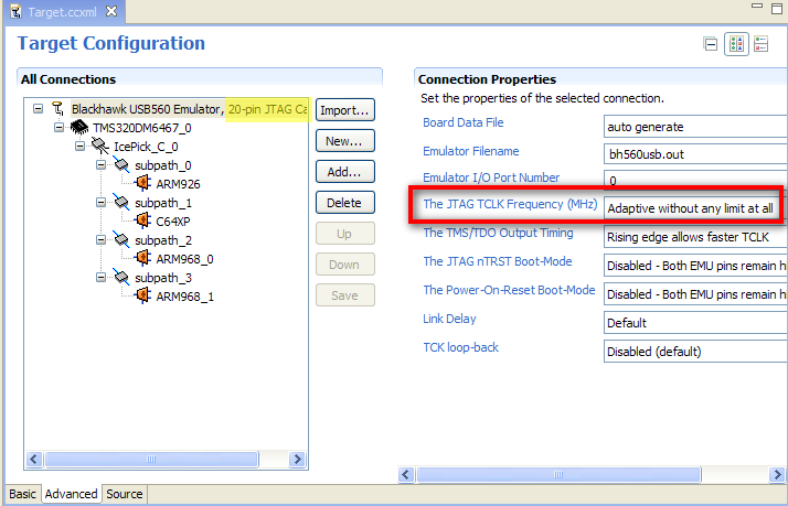

  • Ok, I think this is more or less resolved now.  For the 510 emulators the best solution was simply to NOT use the adaptive clocking board!  I'll try to summarize a few of the high points.
    Our newer devices (I think everything that followed DM6446) we have built additional capabilities into the emulation logic (ICEPICK_C).  These additional capabilities remove the need for the external adaptive clocking board.  Perhaps going further, trying to use both the external adaptive clocking board and the integrated capability actually resulted in a configuration that won't work at all!  I could not connect regardless of TCK speed, etc.
    There is a way to turn off the integrated capability.  I do not recommend turning off the integrated capability.  However, if you really need to do it for one reason or another, here's a quick summary:

    Blackhawk USB510L
    • Blackhawk was going to add an option in CCS to allow this.
    • The test patch they gave me added an option on the "Advanced" page of the target configuration ccxml file.
    • Clicking on the emulator under there is a checkbox for "Using BH-EMU-JACK with TI ARM device".
    • Checking that box will allow you to use the JACK instead of the onboard adaptive clocking.
    • Again, my experience (on DM6467 specifically) was that using this option was less stable than simply using a straight hookup at the 10.368 MHz legacy speed.
    Here's a screenshot of the new option for the Blackhawk.  I'm not positive yet this will be broadly released, but this is what it looked like:
