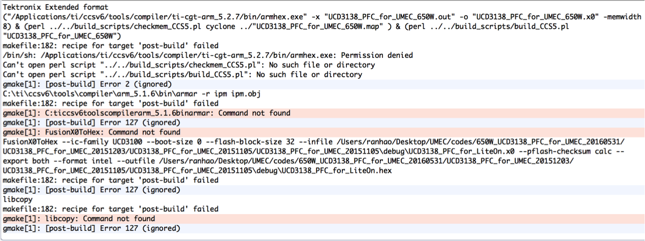

  • Hi AratiG,
    Thanks for your patiently answer, I already fixed those problem by applying your reply.
    But there has another problem is:
    Does FushionX0ToHex has Mac version? I thought this is last problem, if I get through this then I can compile it correctly.
    The only thing I need is to generate the right .x0 file to download firmware to my board.
    Thanks for helping me soooooo much, REALLY appreciate it !
  • The post-build step is invoking armhex.exe which is the Windows executable. The MacOS executable is just armhex.
    The next error indicates that it is not able to find the perl scripts at the specified directory.
    One of the errors following that is because the command is calling the armar tool from a Windows directory.
    All of these commands have to be updated for Mac and to reflect the correct paths.
