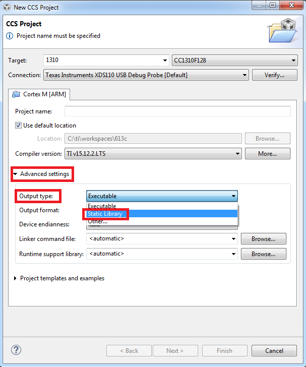

Can anyone tell me how to create a library for CC1310 in CCSv6.1.2? After creating library, I hope that in my project, I can conveniently call functions defined in library.

You will need to change the output type to a Static Library when creating a new project:
This will configure the project as a library project and generate a library when your build it. The generated library then can be included in another project to call functions in the library as you desire.
