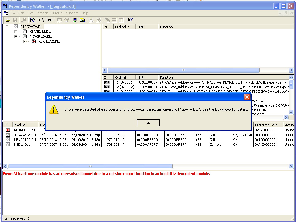

Could Not Load Library
Hi. I'm having an issue with CCS version  6.1.3.00033 with compiler version TI v16.3.0.STS. I performed a fresh install on a machine with a new copy of Windows XP - That's still supported according to what I read. No virus checked had been installed yet. I'm able to compile, but not debug. I get the error below:
Strandgely, the jtagdata.dll file is right there, exactly where CCS said it couldn't open the file.
It seems this isn't a rare problem. There are a few threads on this board about this problem. One suggests reinstalling CCS. I did that, and the problem remained.
