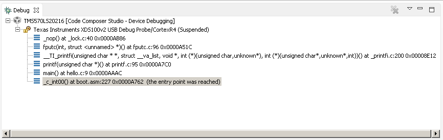

    Using a TMS570LS20216 with CCS 6.1.3 and either the TI ARM compiler start-up code or the HALCoGen start-up code I am unable to repeat this problem, in that that stack backtrace correctly shows the entry point as step through the code. E.g. with a project which use the TI ARM compiler v15.12.3 start-up code:
