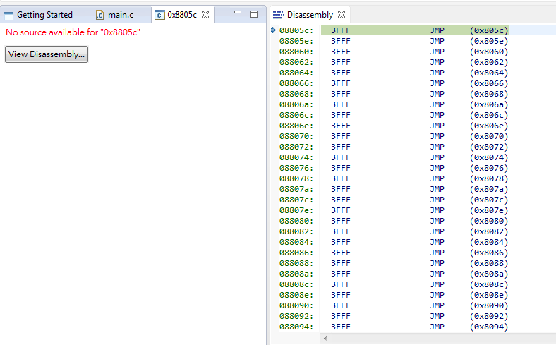

I try to use an MSP430F5529 Launchpad to do UART transmission.
However, I encountered the problem "No source available for "0x8805c"  when entering the CCS debug mode, which was depicted as follows :
Please tell me what can I do to solve the problem, thanks a lot !
    The address 0x8805c isn't a valid address in a MSP430F5529 (see section 6.4 Memory Organization in the datasheet).
    This means the program has "crashed" in some way, and reads from "vacant" memory addresses return the word 0x3fff which is an instruction which causes an infinite loop.
    When you start a debugging session does the program successfully reach main?
  • Thank you for your reply.
    I set a breakpoint in the main section, but the program never ends on it.
    However, I ran the program successfully a few days ago, I still can't find the solution until now.
    Do the compiler or linker report any warnings when building the program?
  • No, the compiler and the linker worked well and no warning message is presented.
    But sometimes in the debug mode, the warning shows that .out file cannot be opened,
    I should do "clean all" and to build the project again so the program can into debug mode successfully.
    These two files are my code
    I created a new project in CCS 6.1.3 and added these two source files to it. I was able to build and load the code and it automatically halted at main when loaded to the MSP430F5529 Launchpad.
    Which version of CCS and compiler tools are you using? Can you try creating a new project and then adding these files to it, and see if that helps?
  • My CCS version is 6.1.2.
    So the code will halt at the main and cannot get into the while ?
    while(1){
    if(counter == 2500){
    data_transmit( txPkt, 1) ;
    Besides, I have tried to create a new project and put these two files in it,
    but it still showed "No source available for "0x8805c" in the debug mode.
    Thank you for your help :)
    I don't know why your code is going to address 0x8805c. I am attaching the .out file generated from my build (which I am able to load and halt at main). Perhaps you could try loading it directly. You would need to start a manual debug session (please see this wiki page on how to do that), then connect to the target and load the program.
    One change I made to the code was to comment out line 89 of main.c to avoid the really long delay, but this should not impact the loading of code and getting to main as this routine is called after main.
    test_msp430f5529.zip
  • Thank you for your reply,
    I tried "clean all" several times and then re-compile,
    the memory problem was solved, thank you all :)
