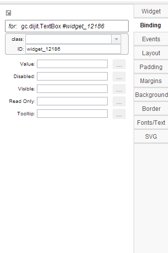

    I did the following:
    There isn't an OnPropertyChanged function, however, there is a onchange in Widget's Events tab.
    I added a function name to the Widget's onchange, i.e.
    I then added the following to the app.js:
    function ValueChanged()
    	var t = $TI.GUIVars;
    	var var0 = t.getValue('Windspeed');
    	dijit.byId('widget_12186').set('value', "Windspeed is " + var0);
    The textbox widget:
  • Also, is there a way to have the GUI composer to work with the CCS5.5 simulator. It would be much easier to test out the GUI without having to download it to the actual target every time.
    The OnPropertyChanged function is tied to GUIVars, not to the TextBox widget. Please have a look at the presentation I linked to in my previous post. Slides 61-64 show how to create GUIVars and set the OnPropertyChanged function.

  • stevenh said:
    How do I create more than one line of text in the text box?
    For multiple lines, you can use the TextArea widget instead. You can use \n for line break.
    dijit.byId('widget_12186').set('value', "Windspeed is " + var0 + "\nTemperature is " + var1);

  • stevenh said:
    Your example (i.e.dijit.byId('widget_12186').set('value'"Windspeed is " + var0 + "\nTemperature is " + var1);)  doesn't cause GUI composer to print the output on two lines.  GUI composer seems to be ignoring \n.
    Did you make sure to use the TextArea widget instead of the TextBox widget?
    stevenh said:
    Why is the contents of app.html (contained in the GUI Composer project directory)different than the source shown in the GUI composer?
    I'll have to get some help on this and get back to you.
  • Ok, It works with the TextArea Widgit.
