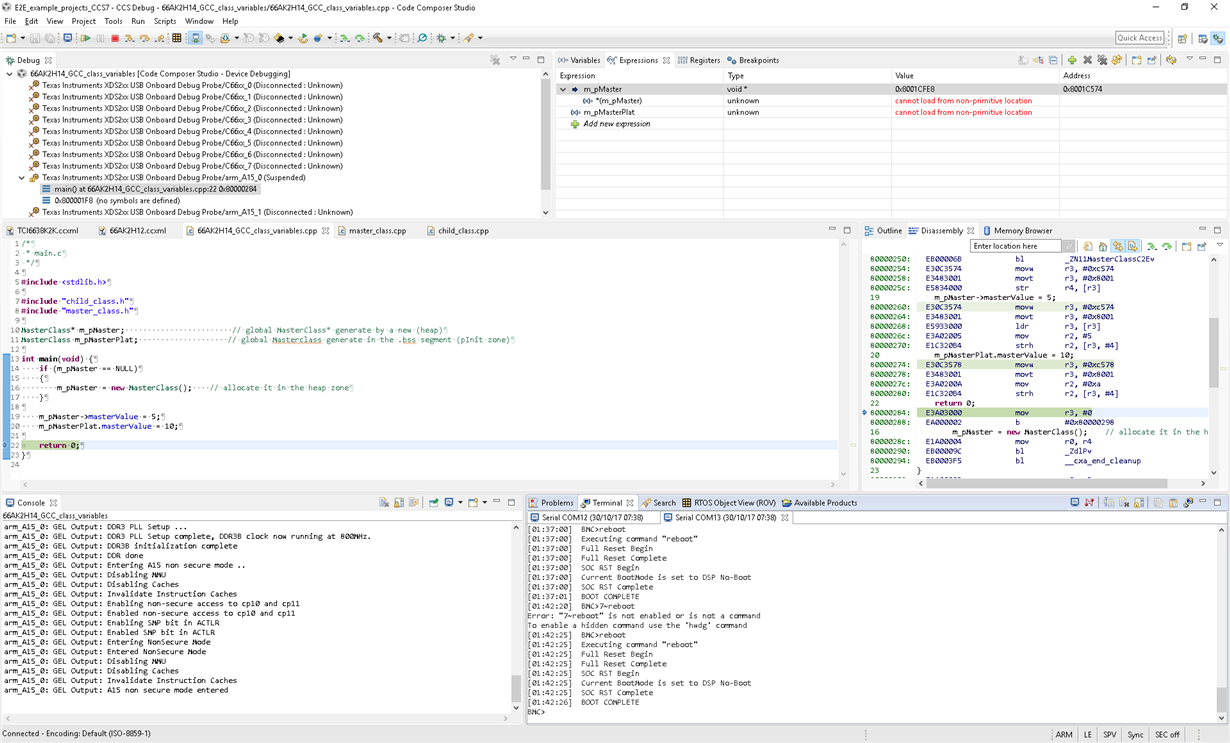

I am having trouble debugging objects that are of a class derived from an abstract base class, i.e. containing pure virtual functions. If I create a new instance of the derived object and try to view it in the Expressions, I get a message that says: "Error: cannot load from non-primitive location".  Yet the object operates as I would expected it to. If I step through code and into the object derived from the abstract class, I can not see an member variables (inherited or not) in Expressions. When I try to view 'this' the debugger shows the proper class under the type yet when I expanded 'this' (to see members) I get type as "unknown" and for value: "invalid member name in macro". Might that be a clue?

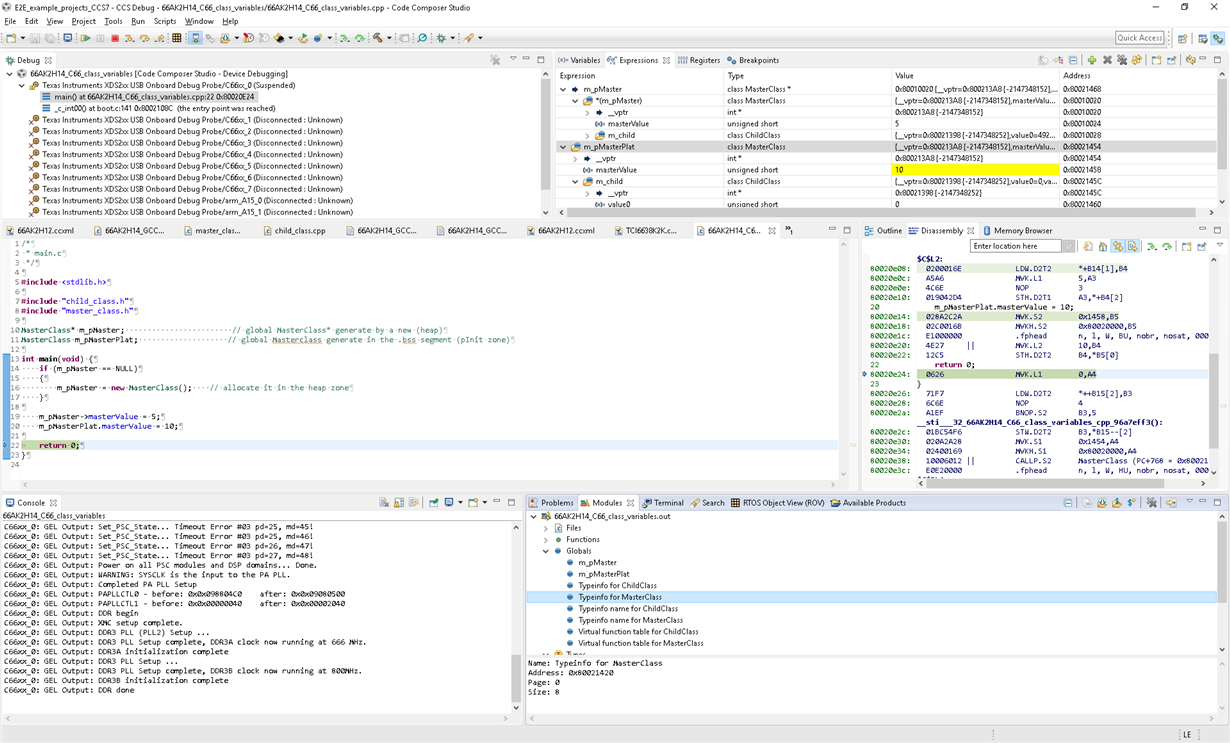

    I ported the previous bare-metal example of the problem to run on the Cortex-A15 core of a EVMK2H. Using CCS 7.3.0.00019 running under Windows.
    When the program was compiled for the Cortex-A15 using GNU v4.9.3 the CCS 7.3 debugger fails to display the values of the m_pMaster or m_pMasterPlat class variables:
    Compiling the Cortex-A15 program using GNU v6.3.1 and the CCS 7.3 debugger still fails to display the value of _pMaster or m_pMasterPlat class variables:
    I.e. changing from GNU v4.9.3 to v6.3.1 doesn't fix the problem.
    The project used for the Cortex-A15 core is attached. 66AK2H14_GCC_class_variables.zip There are separate build configurations for GNU compiler versions v4.9.3 and v6.3.1.
    The same test program was compiled for a C66 core, using TI compiler v8.1.4. The CCS 7.3 debugger correctly displays the value of _pMaster or m_pMasterPlat class variables when the program is run on a C66 core:
    The example for the C66 core is attached 66AK2H14_C66_class_variables.zip
    Not sure if the problem is how the ARM GNU compiler is encoding the debug information, or how CCS 7 is interpreting the debug information.
