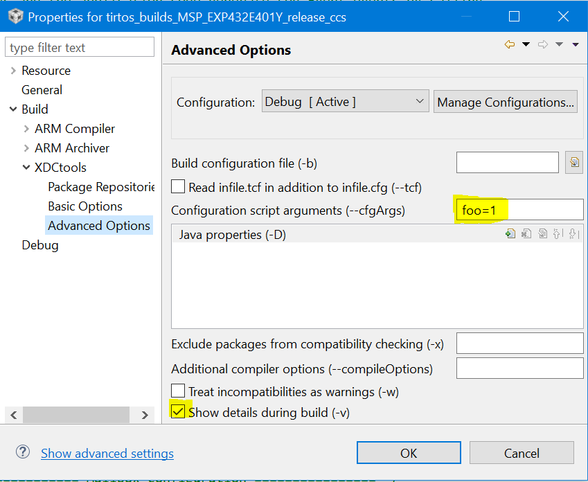

  • Hi Duane,
    You can pass into configuro via --cfgArgs. For example, I add "foo=1" here in project properties (along with verbose output):
    Then in the build output you'll see --cfgArgs "foo=1".
    In the .cfg I added this and I got "howdy1" in the build output.
    if (foo) {
    print("Howdy" + foo);
    You can get the compile options specified by the xdc target, but those are the ones I think you want. You are looking for the ones that you define in the project properties...correct? Unfortunately other then replicating the ones you are interested in via the cfgArgs, we don't have a way to get to these in the .cfg file.

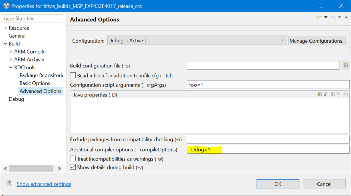

  • The compile options I am looking for are passed to the configuro script on the command line when configuro is invoked.
    Other things in Configuro have access to this, I just need access in the 'release.cfg' file
    From within the 'release.cfg' file - how can I get access to all of the existing cmd line parameters passed to the configuro invocation?

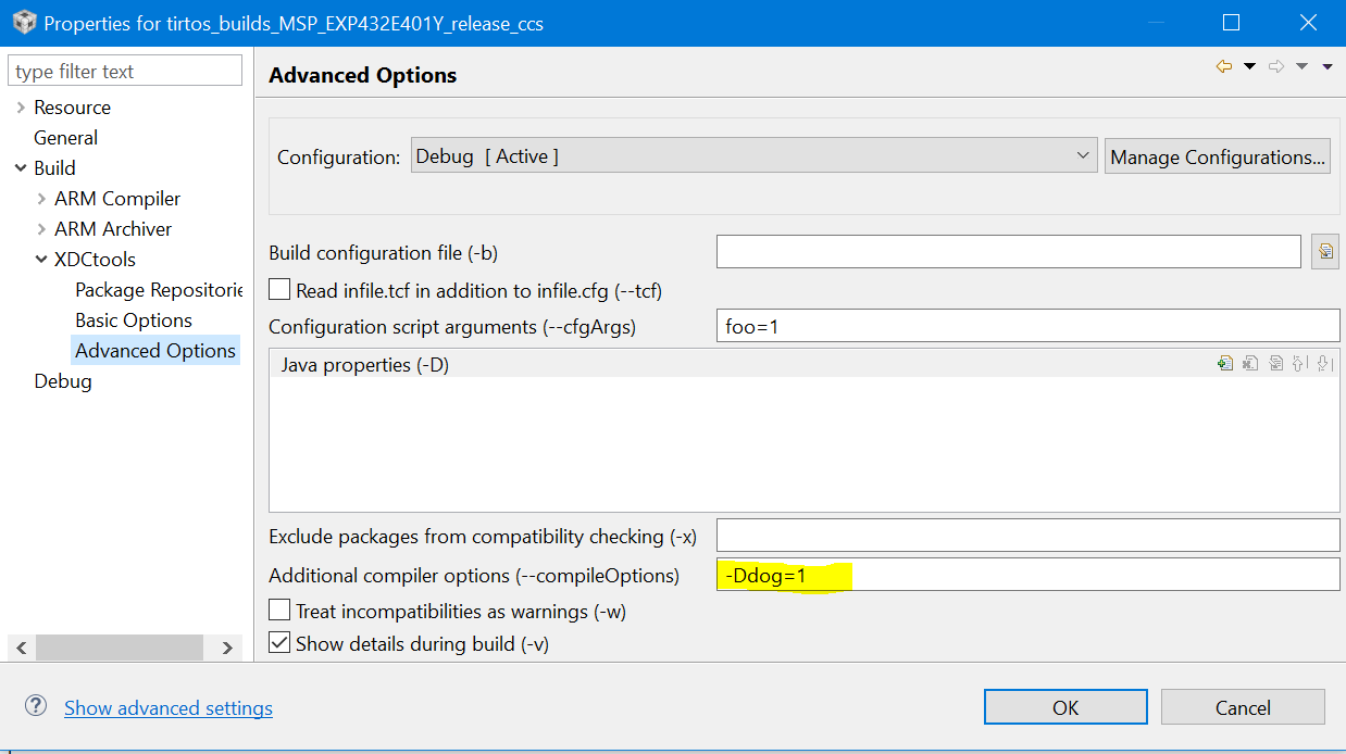

  • You can parse the output of Program.build.target.ccOpts.prefix in the .cfg to get the --compilerOptions settings. For example I have
    Then in the .cfg, I do
    print("profileOpts.compileOpts" + Program.build.target.ccOpts.prefix);
    I get this. in the build output:
    profileOpts.compileOpts-Ddog=1 -qq -pdsw225
    Please note, these compiler options are only being use in configuro to build the kernel. As is, none of the application source files (e.g. main.c) would not have "dog" defined.
    Todd
  • You gave me the clue I needed - this gives me what I want:
    print("===================================")
    print("Options are: " + Program.build.target.ccOpts.prefix) ;
    print("===================================");
    From this, I can inspect the string, and find the "-D" options I am looking for.
