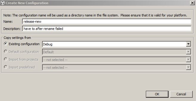

Part Number: CC2640
Pretty straightforward issue, see image:
Gotta be a simple answer but I can't find it?
Dale
Part Number: CC2640
Dale
Dale,
This is actually the intended behavior as copying from an existing configuration is really the only valid choice for CCS projects. Although Eclipse supports/exposes the other options, they are not really supported by CCS projects.
