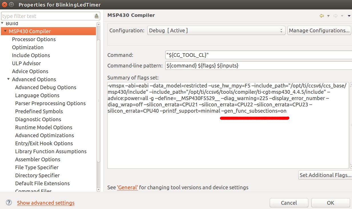

  • I just tried it but it is not working. I have the same amount of sections.
    I added the following line to the compiler options : --gen_func_subsections=on

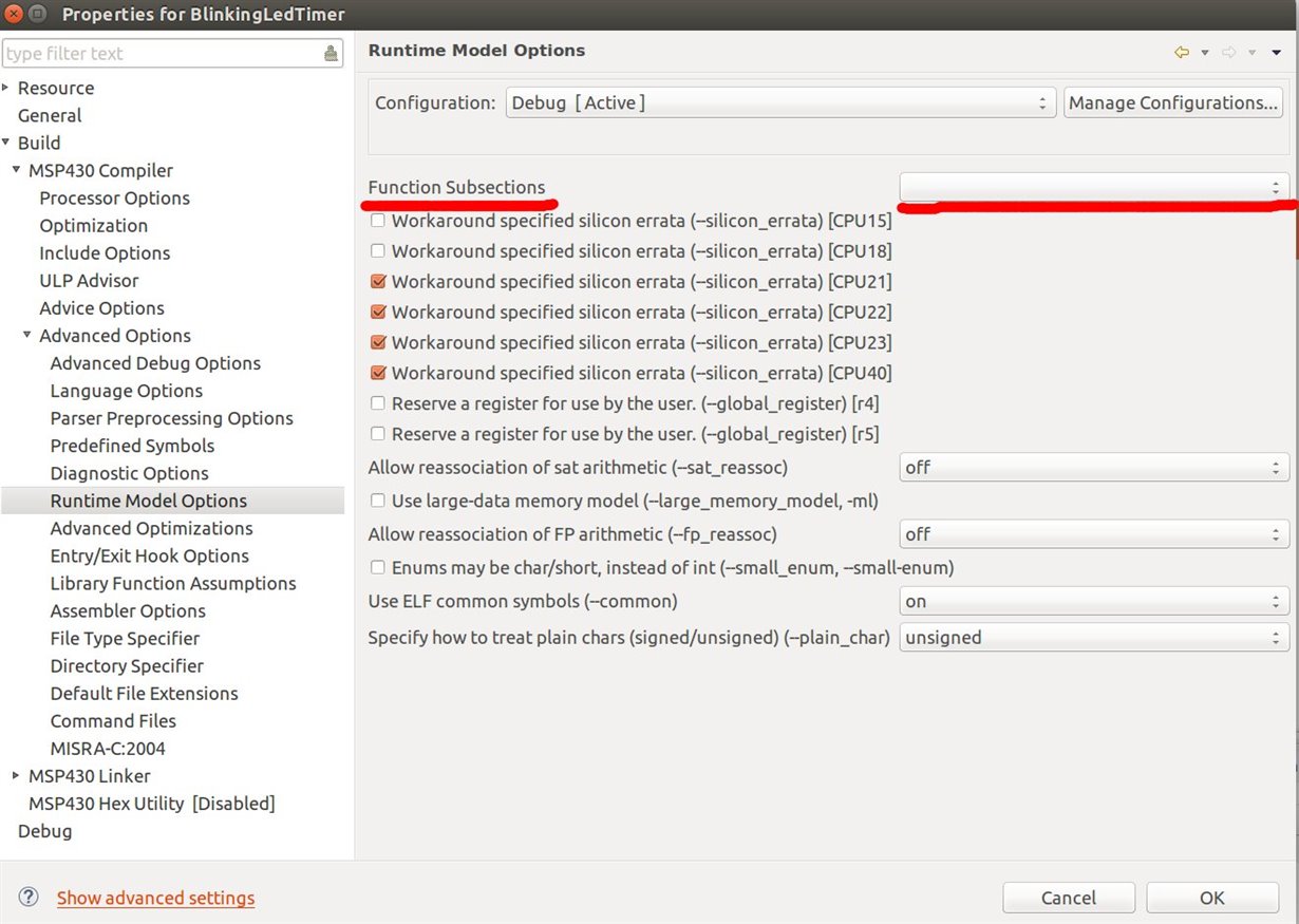

    I checked in the options just in case I was writing it wrong or something, but the option is not working in the GUI. The options are not shown.
    If you try to set a value, the list box is empty. So this is how the options of my compiler look like:
    Thank you in advance.
  • Jon,
    For the MSP430, looks this option is being set by default by the compiler. If you take a look at the link map file after the build and see sections named like (.text:name_of_function) for each function, then the option is already enabled. If the option were not turned on, the sections would be just (.text) without the function name appended.

  • The linker collapses the various .text:one, .text:two, etc, into a single .text. This is controlled by the linker command file. You are looking at the "output sections" in the executable object file. The linker map shows you that the "input sections" do in fact have subsections (e.g. .text:main). However, the input sections are gone in the executable object file.
    The option -gen_func_subsections only controls whether the compiler generates subsections. it does not affect the linker.
