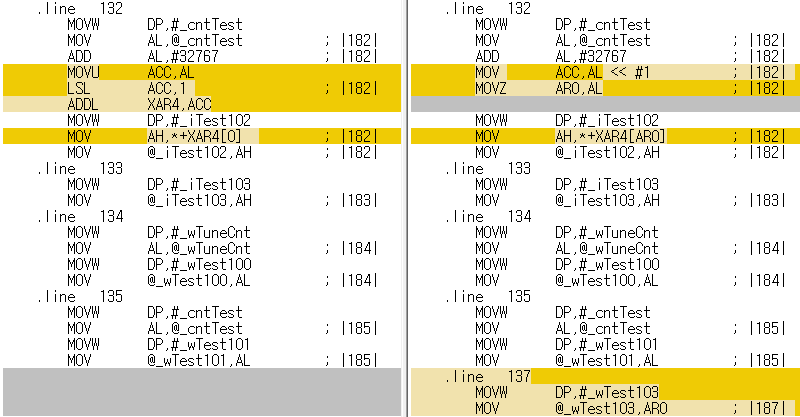

It seems that there's a problem in the compiler when using optimization option(-O0 through -O3, I didn't test -O4 option). Refer to the following two sample codes. Note that the only difference in each code is just one line which marked as bold red in the Code 2.
Even though wTuneCnt and cntTest has the same value, iTest101 and iTest102 has a different value.
The tested compiler versions are 4.1.3, 5.2.12, 6.4.9.

The asm file for each code is shown below. The left is code 1, the right is code 2.
I can't figure out what is the problem?

  • The line by line analysis of the left assembly code reveals that it has a problem.
    iTest102 = pTraceData[cntTest*2 - 2];
    is translated into
            MOVW      DP,#_cntTest           ;(1)
            MOV       AL,@_cntTest            ; (2)
            ADD       AL,#32767                 ; (3)
            MOVU      ACC,AL                    ;(4)
            LSL       ACC,1                          ; (5)
            ADDL      XAR4,ACC                 ;(6)
            MOVW      DP,#_iTest102          ;(7)
            MOV       AH,*+XAR4[0]            ; (8)
            MOV       @_iTest102,AH         ; (9)
    XAR4 is used as the address of pTraceData[cntTest*2 -2].
    Originally, XAR4 has the value of the address of pTraceData[0].
    By ADDL XAR4,ACC, XAR4 is supposed to have the address of pTraceData[cntTest*2 -2].
    But from the following analysis, it shows that XAR4 has a wrong value.
    At (4), ACC = cntTest + 32767
    At (5), ACC = (cntTest + 32767)<<1
    At (6), XAR4 = &pTraceData[0] + (cntTest + 32767)<<1
    But, (cntTest + 32767)<<1 is different from cntTest*2 - 2, which is the programmed in the C code.
    (cntTest+32767)<<1 = (cntTest+0x7fff)<<1 = (cntTest + 0x8000 – 1)*2 = cntTest*2 -2 + 0x10000 , which is incorrect,
    Is there a compiler which fixes this bug or any workaround?
  • What is the type of cntTest?
  • cntTest is unsigned int.
    And wTuneCnt is the same as cntTest.
  • Okay, I've created a test case which demonstrates a problem with 16-bit expressions as array index. I've submitted SDSCM00052881 to track that issue. I don't know for sure that this is exactly the problem you are having, but it seems likely. If you would like to submit a more complete test case, I can compare it with SDSCM00052881 to see if they are affected by the same bug. Please make sure you submit a compilable test case that has been pre-processed.
