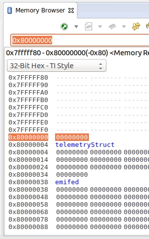

EDIT 1:
When i tried to save changes to a global variable, changes didnt work, and in the memory map value at the adress is 0, but the value name is "emifed"
uint32_t emifed __attribute__((section(".sysmem")));
void (){
emifed = 2;

  • Thanks, i decided to do as you said. So what i dont undertand here is the folowing.
    Now i have
    #define NUM_OF_PACKS        1024
    struct TelemPackStruct
                     uint32_t tmMarker;
                     float32_t    wx ;
                     float32_t    wy ;
                     float32_t    wz ;
                     float32_t    m1 ;
                     float32_t    m2 ;
                     float32_t    m3 ;
                     float32_t    q0 ;
                     float32_t    q1 ;
                     float32_t    q2 ;
                     float32_t    q3 ;
         struct BinData{
                     uint32_t seconds            :32;
                     uint32_t indication         :8;
                     uint32_t mode               :8;
                     uint32_t modeArea            :8;
         }binDataTM;
    struct  TelemPackStruct  telemetry [NUM_OF_PACKS] __attribute__((section(".telem")));
    void foo()
            telemetry[0].tmMarker=0xf99ff99f;
            telemetry[0].q0=1;
            telemetry[0].q1=1;
            telemetry[0].q2=1;
            telemetry[0].q3=1;
            telemetry[0].wx=1;
            telemetry[0].wy=0;
            telemetry[0].wz=0;
            telemetry[0].m1=0;
            telemetry[0].m2=0;
            telemetry[0].m3=0;
            telemetry[0].binDataTM.seconds=0;
            telemetry[0].binDataTM.modeArea=0;
            telemetry[0].binDataTM.mode=0;
            telemetry[0].binDataTM.indication=0;
    Memory browser still shows that all telemetry[0] members equals 0 and all of the array members are placed in the emif adress. Everything works except of that. I even tried to make an array volatile, tried to assign volatile object to telemetry[0], tried assign through the pointers. its always empty.
    What am i doing wrong?

  • Yes, now i enabled everything in Halcogen that turns on emif, and i suppose i solved a half of my problem. It writes to EMIF now... but it writes it strange.
    __attribute__((section(".telem"))) volatile  struct  TelemPackStruct  telemetry [NUM_OF_PACKS];
    void foo(){
        volatile struct TelemPackStruct tmToRead;
        //filling tmToRead
        telemetry[0]=tmToRead;
        //telemetry[0].q1=tmToRead.q1; does the same problem
    It suppose to fill elemets telemetry[0] with tmToRead elements. But instead this fills ALL of the telemetry[NUM_OF_PACKS] and only with one variable.  What can this cause?
    That is probably due to some error in configuring the hardware.  We in this compiler forum lack the expertise to help with that.  I recommend you start a new thread in the Hercules device forum.  Or, if you prefer, I can move this thread into that forum.
