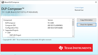

1. Yes, the DLP3021-Q1 can support a monochrome or white-only LED. DLP Composer uses the red channel for single LED output mode. To generate a single channel output with DLP Composer, you need to change the sequence duty cycles to R=100, G=0, B=0 in, and then change your image format to “grayscale” on the image/video tab in Composer:
Tell me how to open an additional column with settings from your screenshot?
I do not have such a column with settings in DLP Composer.
