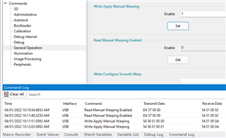

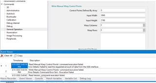

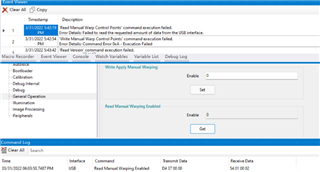

    This day I test DLPC6540 on software version "dlpc6540_lpcw_v4.4.0", and I found that the manual warp commands (0x34~0x39) doesn't work use with  Composer control 15.1.0.37.

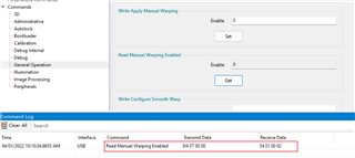

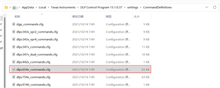

The "DLPC6540_Software_v4.4.0_Release_Notes.pdf" note that, the command 0x37 change to use 0x36, but the Composer control 15.1.0.37 with DLPC654x display controller  still send the 0x37 on "Read Manual
Warping Enabled" button "Get".  It is the Composer control 15.1.0.37 need to be upadte ?
     Please help me and waiting for your respond.
