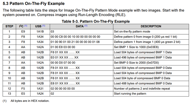

I'm using the DLPC900 Programmer's Guide commands through usb.
Steps on how I use the DLPLCR6500LCR is almost exactly like Section 5.3 below
At step #12, if I set it to loop once, is there a command I could use to check and see that the images have finished looping once?

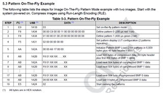

  • Johnny ,
    It turns out there is an error in the example which will be fixed in version H of the guide.
    The best way to do this is to turn on batch file logging and build the batch file and save it.  Then you can correlate the calls that way from the Programmer's Guide.  Here is what will be in the upcoming version:
