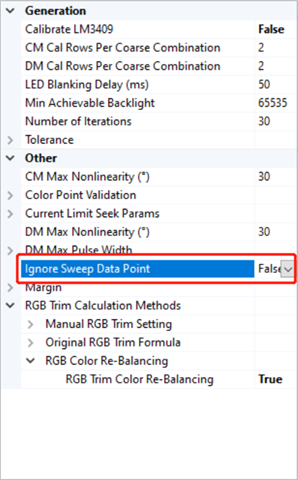

I'm testing the role of several parameters in the Advanced Settings in the new version of DLPC230 ACP(1.60.0.4 specifically).
But I didn't understand what the 'ignore sweep data point' option does, can you tell me?

This parameter determines how to handle the "Color Point Validation" values. If the sweep measures a value that is outside the "Color Point Validation" ranges, and if the "Ignore Sweep Data Point" is set to True, then the Auto-Calibration algorithm will ignore those Sweep Data points.
In short, this parameter is meant to detect / ignore when the color point of a sweep point is outside the expected color (x,y) range.
