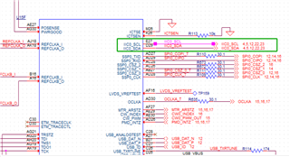

  • Hi, Maybe I find the reason: the eeprom whitch match the DLPC7540 is not work normal, i2c cannot read and write data from eeprom.
    I burned  the TI release img into EVM borad, the eeprom also not work. the img version as below. I have checked the i2c address is correct.
    Once power on, no any waveform output from DLPC 7540 ,any configurations shoul I to do ?
  • Hi Jing Miao, Could you read the System status from the Administrative page of control program and confirm the read status. One reason for EEPROM write failure can be the EEPROM Write enable pin being incorrect, can you check the level of EEPROM write enable pin. the default I2C port and address for EEPROM in the provided flash image is set as Port 1 and Address : 168 please check if you have programmed the same.
  • Hi, the schematic as below, could you help to check two points:
         1. I think the I2C addrees is 160(0xA0),not is 168.
         2. The PIN7 "EEPROM_WP" is low now, this status is write enable,right?
  • Hi Jing Miao, I have double checked that the project configuration is set as follows "I2C address for EEPROM is 168 on I2C Port 1, I2C address for XPR is 160 to be connected on Port2.
    Yes driving the pin low/keeping it floating should allow write transactions on the EEPROM.
  • Yes, there is a EEPROM on PORT1, and i2c address is 168. BUT what is this EEPROM connect to I2C0 used for?

  • Hi Jing Miao, The EEPROM on I2C0 is to only for test purposes and no dedicated functionality assigned.
  • Hi Jing Miao,
               The Eeprom configurations are not directly written with the flash data upon bootup. To store the EEPROM data after power up, user can send invalidate settings option in the administrative page as below. Then the Flash data is written to the EEPROM and retained from then.
  • Hi Venkata Pavan Mahankali,
    Thanks for your support! I have find the cause of these quentions: we select the wrong eeprom chip for dlpc7540, so the appdata cannot write to the eeprom once power on, also the image processing data all are “0”(such as contrat、brightness、RGB gain....),that's the reason why the image display balck when i connect hdmi source or switch Test Pattern.
