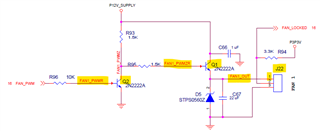

    The LED D7 behavior is normal which indicates 12 V power is fine. Can you probe the highlighted signals around the fan circuitry to see if any of these signals are high? Fan pwm is coming from the DLPC350.

  • Hi Alex,
    Sorry, I am unable to probe the highlighted signals around the fan circuit.
    I don't have any measuring tools here. During the measurement process, it should be necessary to disassemble the DLP board.

  • Hi Alex,
    The following is my result of measuring the voltage of the fan circuit.
    The voltage values measured below are all relative to the ground.
    After connecting the power supply, the base voltage of transistor Q1 is 11.85V, and the base voltage of transistor Q2 is 0.11V.
    The voltage at pin 1 of J22 was initially measured at 8.39v, but the voltage at this pin continued to decrease and eventually dropped to 0.
    The voltage at pin 2 of J22 is 3.09V. During this period, the temperature of the DLPC350 chip was very high and a burnt smell came out.
