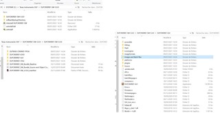

Hello everyone,
we use a DLP9000 for a holographic application.
The DMD is installed on a WQXGA type A board connected to a Hi-Res Dual DLPC900 main board. To communicate, we use the DLP LightCrafter DLPC900 GUI 5.0.0.
During operation in the "pattern-on-the fly" mode, an error occasionally occurs. This error seems to be similar to the one described in the document "DLP products technical advisory" (DLPT028, sept. 2019).
Furthermore, via the GUI, standby mode and park mode are not accessible and return an error.
Is there a more recent version of the GUI? If so, where can I find it?
I'm also attaching views of the software installation directories.
