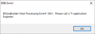

  • Hello Lori,
    I will descrilbe the issue I'm stucking.
    What I want is to change duty of segment in Light Control 7(3Seg) sequence as bellow.
    Red 175 -> 160 degrees
    Blue 56 -> 53 degrees
    Green 129 -> 147 degrees
    I have changed it just editing Duty Cycle Settings in Hybrid Configuration tab.
    Then, after I have tried to excute build, BSB Error appears.
    The detailed error messages are bellow.
    Sequence Set Definition
    Starting a build...
    Validating inputs...Finished.
    Running the Bit Sequence Builder engine...Finished.
    Build failed. See the Bit Sequence Builder log output for details.
    Group# 1, rate# 0, Creating Seq Data...
    BitSeqBuilder Fatal Processing Error# 3061. Please call a TI application Engineer
    ERROR occurred in processing block# 23
    Also, attached to this reply, please find the full log of Bit Sequence Builder.
