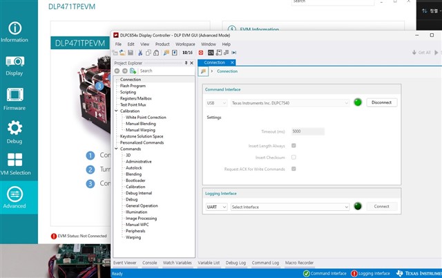

  • Hello, Lori Wang.
    I installed the bootloader as described in the documentation, but the DLP EVM GUI does not recognize it. I have a few questions.
    In the DLP LightCrafter 4500 documentation,
    1. it's J30 where the jumper should be connected.
    2. Start Address (HEX) : 0X00000000, SIZE (HEX) : 0x0020000
    In the Display 471TP EVM,
    1. Is it J9 (Header for BOOT_HOLD jumper)?
    2. Should I set the Start Address and SIZE to the same? The initial value is SIZE 0x00008000.
    I have repeated the Section 4 process several times as recommended in the document, but it is not recognized.
    1. I'm getting an error that the FlashDeviceParameters.txt file is missing. Should I have that file?
    2. Can I get the board files and .bin, .txt files back. Please.
    And, is there anything that can help?
    Thank you.
  • Hello TAE-YOUNG,
    1. Did you connect the J20 for ASIC JTAG cable for programming the bootloader?
    2. Please try to use Start Address (HEX): 0x00000000 and Size (HEX): 0x0020000.
    1. If you try to continue click "OK", does this error message disappear?
    2. What do you mean get the these .bin and .txt files back?
    Lori
  • Hello, Lori Wang.
    Thank you for your reply.
    1. Yes. I connected the UH232H to the J20 for ASIC JTAG cable.
    2. Yes. I tried 0X0020000. When the program ends, SIZE changes to 0x0000C230.
    When click the Flash Info button, will see :
    After completing all the steps I tried to update the firmware from the DLP EVM GUI(3.2.0.6) but it did not connect.
    1. 1. Yes, the error message is disappear.
    2. Requested the FlashDeviceParameters.txt file for DLPC6540 (DLP471 ENM)
    - Flash memory information
     Mfg : MICRON
     MfgID : 0x0089
     Device :  28EW256ABA1H
     DevID : 0x227E
    From the link www.ti.com/.../DLPC900REF-SW, I got FlashDeviceParameters.txt Version 4.
    // Mfg MfgID LMfgID, Device DevID LDevID,
    "Micron", 0x0089, 0x0000000000000089, "MT28EW256", 0x227E
    Even if I comment out other chipset parameter information and upload the bootloader, it still isn't recognized.
    Is it possible that the cable length connecting JTAG (UM-232H) and J20 is the problem?
    Please let me know if you have any other issues.
    Since I asked the question using Google Translate, there may be some parts that are lacking in conveying the content. Please understand.
  • Hello, Lori Wang.
    The bootloader is installed. After using JTAG FlashProgramer, the bootloader update tool successfully detected the device.
    And I checked the USB connection in the command interface of the DLP EVM GUI.
     - For testing, I did not connect the jumper to J9 when using JTAG FlashProgramer.
    Now I will check the performance of the board by combining the projector. I will ask questions while developing.
