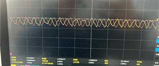

We now have a relative question with the previous issue(https://e2e.ti.com/support/dlp-products-group/dlp/f/dlp-products-forum/1470109/dlpc410-the-issue-about-glitches-of-the-image-displayed-on-dmd). According to your suggestions, we conducted tests on the A B C D bus and observed discrepancies between the B bus and the other buses. The differences among the A C D buses were minor, suggesting potential issues with the B bus. We will inspect the circuit routing of the B bus.
Based on the test results, a new issue was identified: Between the APPSFPGA and DLPC410, the phase difference between the clock and data signals on the C bus is nearly 0°. However, between the DLPC410 chip and the DMD, the data lines exhibit a phase delay of approximately 270° relative to the clock lines (or equivalently, the clock lags the data lines by 90°). Similar behavior was observed on the A and D buses (see figure below: yellow represents clock signals, red represents data signals).
Notably, the DLPC410 documentation specifies that data bus signals should lag clock signals by 90°. Despite this apparent discrepancy, the DMD displays images normally via the A C D buses.
Now we need to verify: Could there be timing or routing issues between DLPC410 and DMD on buses A C D?

    Which image is the B and which is from A,C,D?  The clock does not look very clean in the second image clock does not look as clean as the first image.

  • Fizix,
    Yes, the waveform in the second image is not clear, which might be related to our testing equipment, possibly due to high noise levels.
    Both images show results from the C bus (similar to A and D buses). The first image displays waveforms between the APPS FPGA and DLPC410, while the second image shows waveforms between DLPC410 and DMD.
    According to DLPC410 chip specifications:
    1. In the first image, the phase difference between data and clock should be 0° (actual measurements match theory).
    2. In the second image, data should lag clock by 90° (measurements show clock lags data by 90°, with yellow representing clock and red representing data).
    We are concerned about potential layout issues with the ACD bus (despite normal DMD display performance).

  • How does the B bus DLPC410 to DMD look?
  • Fizix,
    The first image displays waveforms between the APPS FPGA and DLPC410 from B bus, while the second image shows waveforms between DLPC410 and DMD.  The phase difference between the APPSFPGA and DLPC410 is abnormal.
    Jing, Miao
  • Jing,
    The second image seems to pinpoint your issue.  That needs to be lined up to look like the inputs on A, C, & D.
