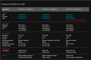

    I would like to bring out certain differences between the two chipsets, that might be essential for your application:
    1. The DLP553x chipset can be used to achieve a higher brightness and resolution than the DLP3030 chipset. See spec in the image below.
    2. The DLP3030 chipset while being automotive grade, is not functional safety qualified. The DLP5530S and DLP4620S are Functional Safety Quality Managed. See Reliability and Functional Safety Overview for more information.
    We can provide a mono-green project for DLP3030PGU. Would it be possible to contact you over email?

    Thank you for letting me know the difference between DLP553x chipset and DLP3030 chipset. This time I want to evaluate PGU, so I will evaluate DLP3030 chipset. I would like to evaluate DLP553x chipset in the next stage.

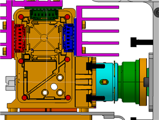

    I was able to get help in obtaining a step file. Please view at your convenience. The specific internal design of the PGU cannot be shared, though, as this was designed by a third party OEM. I hope you understand.
    CustomerGen1.5CombinerHUD.zip

    Thank you for the step file. I have checked it.
    Most of the questions have been resolved. I guess the optics is an x-plate design.
