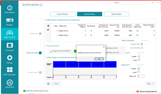

    2. I am facing an issue with pattern streaming from flash memory via the GUI. I created one vertical and one horizontal pattern set, defined their timing and order, and then loaded them to the flash memory (please see the attached image). However, when I click the "Run Once" button, only the first pattern set is displayed, and "Run Continuously" does not function as expected. If I remove one of the sets, it works correctly. Could you please guide me on how to properly configure multiple pattern sets for correct playback?

    Regarding the issue with pattern streaming from flash memory via the GUI, can you share the patterns used and the order. Can elaborate on the issue which you see when you click run continuously.
    Kirthi Vignan.
  • Hello Kirthi,
    Thank you for the response.

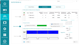

    I am trying to check internal pattern streaming via GUI without camera interface. Suppose I need to project 5 grey coded 1-bit vertical patterns followed by 5 horizontal patterns.
     First, I created pattern set from saved folder in .bmp format.
    Click next to pattern set window where I set the timing configuration and enable trigger out 2 with zero delay and keep pattern set entry index 0. For both patterns set timings set as,
    Preexposure: 45000 microsec
    Exposure     : 1000000 microsec
    Postexposure: 8000 microsec
    Then click on load pattern and program shows the below pop-up and click OK.
    Click "Set" button in pattern control window.
    When I click the 'Run Once' button, only the first set of patterns (vertical) is projected, and then it stops.
    When I click 'Run Continuous', only the first set of vertical patterns is projected, and it does not continue looping. I then have to manually click the 'Stop' button.
    I request your support.
    -Basith
  • Hello Basith,
    Please see the readme for the firmware on this controller:
    https://software-dl.ti.com/dlp/pico-fw-selector/release_notes/FWSel_DLPC3478_DLPA2005_pm1_i2c0x36_v9p2p0.html
    Please see the note highlighted from the Internal Pattern table.
    Your exposure time is much longer that the table shows for any mode under "Exposure Time Range" which can result in the second set not showing.
