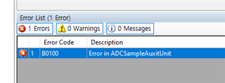

While evaluating the duty cycle of DMD4620S-Q1 EVM using DLP Composer, there is an error under the specific conditions below.
I was wondering about the guide to Duty settings and how many decimal places are possible.

The program version used is DLP Composer (Automotive) 1.17.0.18, and the error message is shown below.

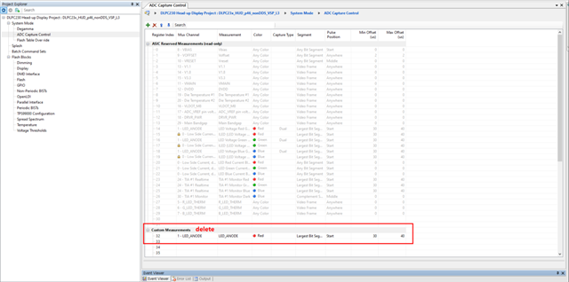

Kim,
Can you please share a snapshot of your 'ADC Capture Control' page in Composer project? If you see a 'Custom Measurement', please delete that entry and try to build again.

Hello Kim,
After deleting the custom measurement entry, do you still see the error?

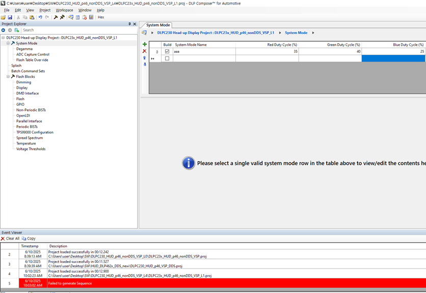

Lee,
Thank you for letting me know. Is it the same error as before, for this system mode - 'ADCSampleAuxitUnit' failed?
Aishwarya
Hello Lee,
Thank you for confirming. Would it be possible to export your project and share it with us? Along with all the LED duty cycles you would want to test.
I will make minor modifications so that you will be able to build the project for a variety of system modes.
You can either attach it here, or you could send it over private messages.
