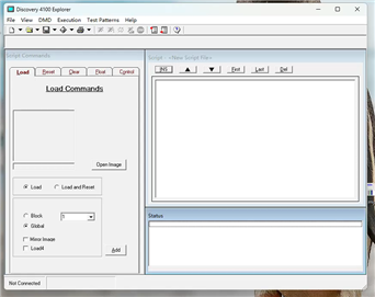

The program log indicates "Pattern sent to DMD" after execution, but no image is displayed on the physical DMD screen. Specific phenomena are as follows:
The program can recognize the device normally (detects 1 device) and correctly identifies the DMD type as DLP650LNIR (DMDtype=7) during the first run;
The FPGA firmware loading step returns failure (program_FPGA function returns 0), but the test display step log shows "100% progress" and "Pattern sent to DMD";

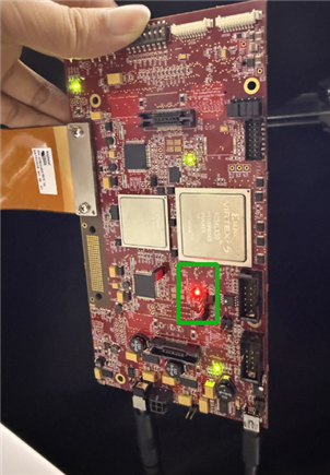

Physical observation: No image is displayed on the DMD screen (black screen) with no white pattern shown;
Additional phenomenon: During FPGA firmware loading, the D2 indicator on the development board turns red (abnormal loading status).

  • Pan,
    Do you have the WIndows GUI installed.  If so can you show a screenshot of the About screen from the GUI.
    D2 illuminated red indicates that the APPS_FPGA is not correctly configured.  Please take a picture of your controller board (front) and post it.
    Fizix
  • Dear Fizix,
    I have already installed the Windows GUI and I can use it directly. You are right, after I run the code, D2 illuminated red indicates. Is that the FPGA version problem? How can I fix it?
    Looking forward to your support, THX!
    Pan
  • Hello again Pan,
    I am sorry, I do not understand what you mean by "after I run the code, D2 illuminated red indicates".
    does the board come up with D2 off and D16 green and then D2 comes on when you run the GUI?  Or when you run your C++ code?
    Fizix
  • Dear Fizix,
    Thx for your reply. When the development board is powered on, LED D16 is green and D2 is off. After running the C++ program, an FPGA firmware loading failure is indicated, with D2 turning red and D16 turning off (abnormal condition). When running the GUI, D16 is green and D2 is off (normal condition).
    Pan
  • Hello Pan,
    Your board is working normally.  The latest boards have SPI EEPROMs.  With these EEPROMs you can no longer push in an FPGA load over USB.
    The SPI EEPROM requires that the FPGA is the clock source for configuration.  The result is that the Cypress USB chip can no longer drive configuration of the FPGA.
    If you are just using the DLL functionality, you should clip out the FPGA load part of your code.
    If you are wanting to change the FPGA code, then you will need to get a Xilinx platform cable.  You should be able to use an aftermarket one.  Use Xilinx Impact tool to push in your bit file.  We have had the best luck with v 14.1 of the Xilinx Lab Tools.  Later versions do not seem to work well with the LX50 and EEPROM.
    Fizix
  • Hello Fizix,
      I have already fixed this problem. THX a lot! All LED is green now after deleting the FPGA part. But now the problem is I set all functions right from D4100_usb.dll, but I cannot see the test pattern on my DMD sceen, you can check a part of my code below, all the feedback is Heavy check mark.
