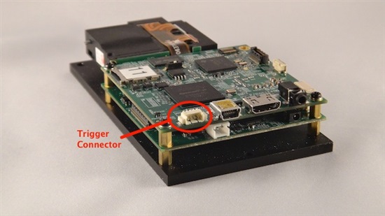

LightCrafter offers several flexible trigger configurations. The trigger connector (J7) lies at the back of the System board (top board):
The pinout of J7 connector is:
  • Pin 1 - Tigger Supply
  • Pin 2 - Trigger Input
  • Pin 3 - Trigger Output
  • Pin 4 - Ground

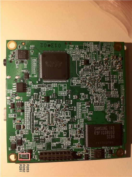

  • Hi Pedro, I need some help interfacing a 5V MCU with the LghtCrafter Trigger inputs.
    I would like to know if there is a simpler way of doing it, without modifying the system board.
    I couldn´t find the R282 0ohm resistor. Where is it?
  • Enio,
    Unless you have a level shifter on the MCU to change the 5V signals to 3.3V, you will have to modify the board.
    R282 is in the back of the SyStem Board (top board). It is in the group of three resistors that has a label next to the daughter card connector. It is between the daughtercard connector and screw hole, next to a ground test point.  R282 is the middle resistor.

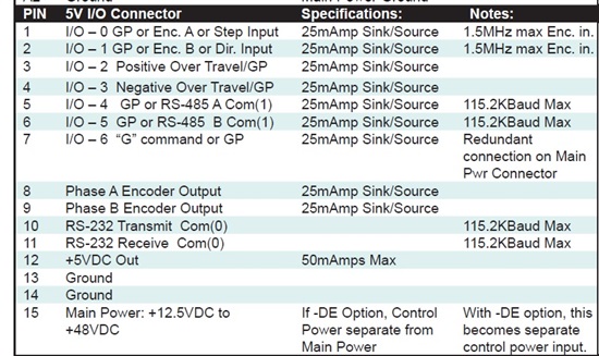

    We also need to have a 5 V TTL trigger signal to the LCr or vice versa. The connector of the external device is DB-15 D-sub (with pins described below). All the seven I/O pins have 10Bit 0-5V DC A/D
    Would you, please, help me in figuring out which pins of the trigger connector should be connected with which pins of the external device. Another issue is that after reading in the forum for users having damaged their LCr during soldering, I prefer to make this offset somehow externally. Does TI produce some level shifters that might be easily integrated without modifying the board in order to work for us?
    I looked for the resistors you specify, i.e. 282 and 285 but on our board are present 292 and 295 near the trigger pins. Are these the same?

  • Jordanka,
    You would use a couple of the pins configured as General Purpose (GP) pins: pin 1, 2, 3, 4, or 7. This connector seems to be from a servo motor. So the pin selection depends on your use.
    From LightCrafter you have a trigger input and a trigger output. Depending on your use, you could have the trigger output connected to one of these GP pins set as an input.  And another GP pin setup as output connected to the trigger input. Depending on your use you might only need the trigger output. For example, the LightCrafter in internal trigger mode will display a pattern and the LightCrafter's trigger output goes high to indicate that a pattern is displayed and this is captured by the servo motor GP input. On the other hand, you could have the motor send a high signal to indicate the LightCrafter to display the next pattern by using an output of the servo motor in GP mode and setting the LightCrafter in external trigger input. The servo motor needs to toggle this pin high to advance patterns.
    Since the LightCrafter is setup for 3.3V I/O out of the box, the LightCrafter 3.3V trigger output could drive the input of this servo motor since most 5V TTL signals need 2.0V or higher to detect a high signal. However, you cannot drive a 5V signal (an output form the servo motor) into a 3.3V logic (LightCrafter's trigger input). Thus, do not connect a 5V signal to a LightCrafter input without adding a level shifter or changing the resistor values.
    For a 5V trigger input, remove R282 and short across R281 to set the input level shifter to 5V.  These are present on the bottom of the board next to the screw and trigger connector.
    For 5V trigger output, remove R292 and short across R291 to set the output level shifter to 5V. These are present on the top of the board next to the screw and trigger connector.
