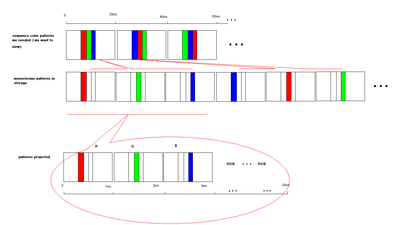

  • Hi Sanjeev,
    We are concentrating on 3D measure with color coding. So we want to know is it impossible to view a color pattern through projecting a series of monochrome patterns sequentially in structured light mode. See attached figure for more details.
    Thank you!
    Weihua

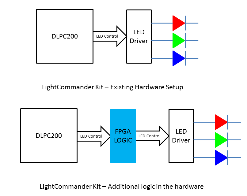

  • Hi Weihua,
    DLP LightCommander(TM) Kit as such it is not possible to show the color patterns in Structured Light mode. It is possible with additional FPGA logic put in between DLPC200 and LED Driver control signals.
    So if you are able to affort additional development cost I can help you on what needs to be added in the FPGA Logic.
    In short, DLPC200 to LED Driver there are four LED_EN signals connected. In case of Strcutured Light mode, the LED_EN signal is fixed i.e., it will turn ON for fixed LED configuration to produce monochrome images. For example - If GREEN LED is selected all the patterns in structured light mode produce green color images ONLY. By adding another hardware processing block (FPGA) the signal can be processed and modified to generate different LED_EN signals to lit-up RED or GREEN or BLUE LED based but this will based on the desired color we want to show each pattern.
    Sanjeev
