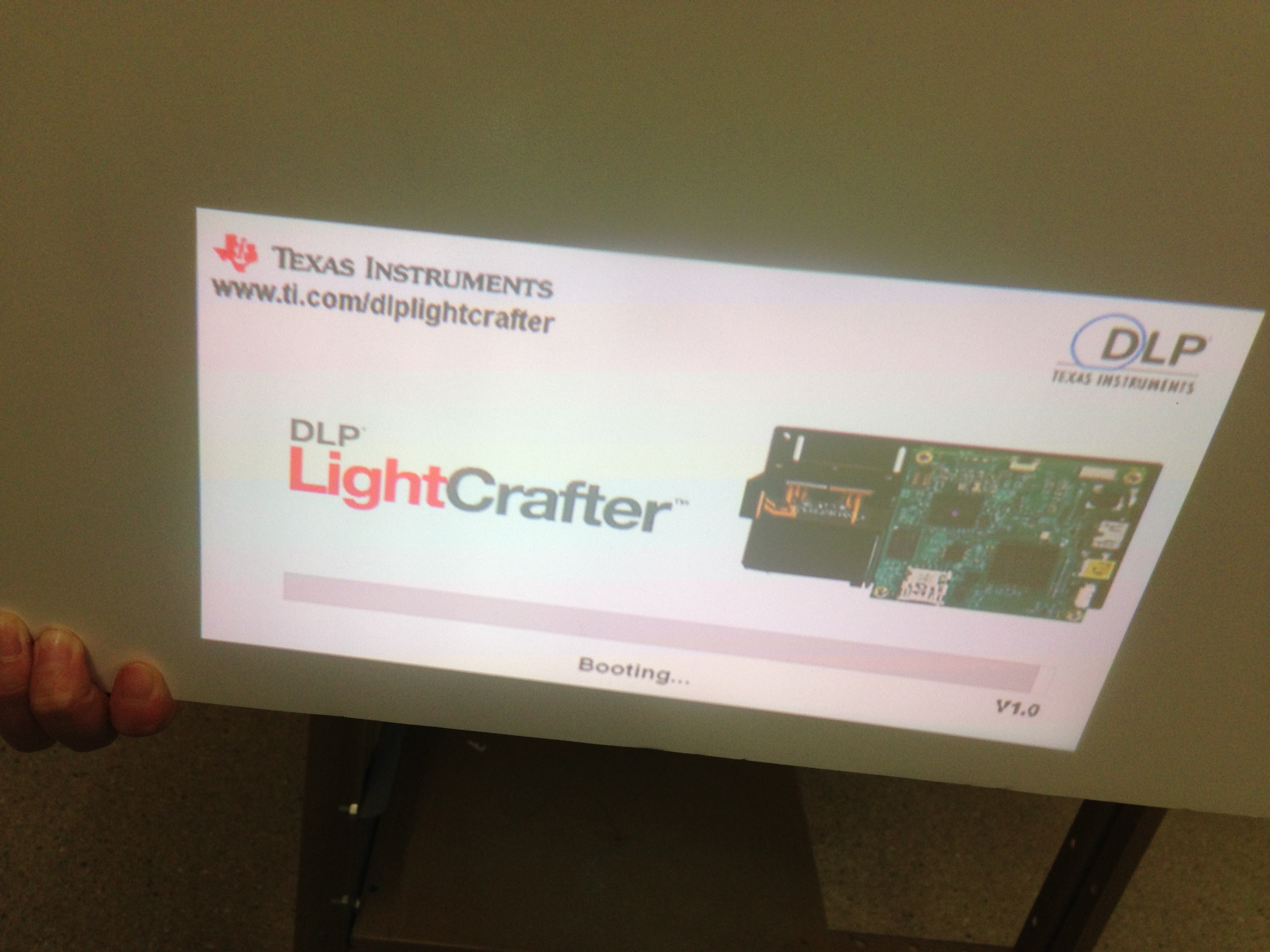

The D1 is  red, D5 is green, the LED near power is green. S1 didn't work. The DMD only display the opening images . is this DLP  damaged? Thanks!

    This looks right. Are you seeing the DLP LightCrafter splash screens with booting status bar on the bottom?
    Once the LightCrafter boots completely it will display RGB colored bar static image. Can you see this image? At this point, D1 blinks red and green.

           It show the booting screen, but it can not finish booting , that is probably the problem .
           I use S1 try to switch to HMDI input, my computer is windows 8, is that why I can not boot?  Thank you very much for your answer!

  • Hey Divya:
           It seems like it stuck at the booting step.
           I download the DLP LightCrafter Firmware & Software Bundle v2.0 for windows.
          Then run the setup file, then find DLP3000-C300REFDM365-v4.0 file in C:// program files/ Texas Instruments-DLP/
          Then uncompress it , it is a file including three documents 1. dm3xx_nand.dat 2. dm3xx_sd.dat 3. lcr_boot_sd.exe
          Then I open MSDOS command shell with "run as administrator" and change to the directory just uncompressed.
            Execute the command:   lcr_boot_sd.exe dm3xx_sdv.dat I: (because the document name is not dm3xx_sdv3_31, but dm3xx_sd, and the sd card mapped into I:drive)
           It showed Image copied to SD card SUCCESS
           then I Insert the micro-SD card with this image on LightCrafter
           then Set the DIP switch on System board to the side closest to the micro-SD card connector
          then Power up the LightCrafter
           But it seems stuck at the booting step, the booting bar stopped at around 90% .
    What should I do next ?    Is this board broken ????
    When I first tried to use this LightCraft several months ago,  it works well.  then I remove part of the light engine and tried again, I broke some pins of the DMD chip, then the LED on the system board became always red, then I bought a new DMD chip and replace the broken one , then the booting screen was looked like the image above , even I tried to boot it by SD card.
    So, is this board broken ?   What should I do to fix it ? Thank you very much for your help!!!

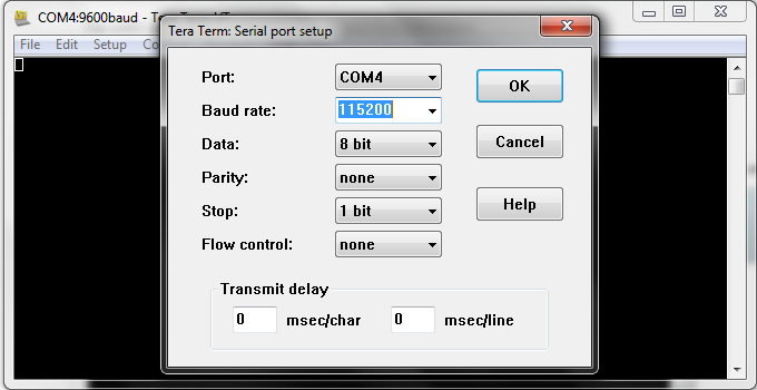

    Can you please connect a UART cable to J1 on the systems board and provide the console log?
    I use tera term as terminal emulator. The serial port configuration should be as follows,
    – Bits per second: 115200
    – Data Bits: 8
    – Parity: None
    – Stops Bits: 1
    – Flow Control: None

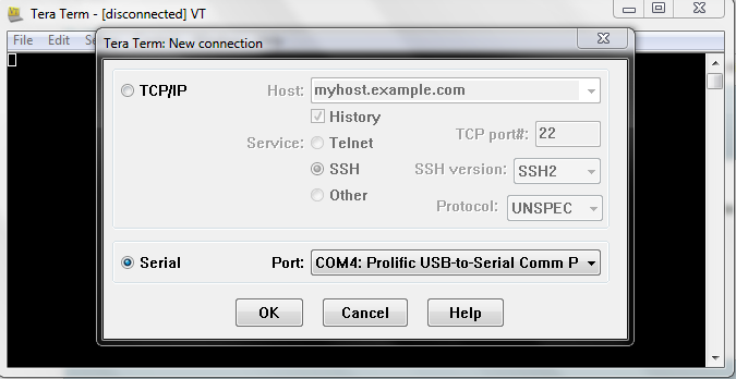

    I connect the UART, but I don't know how to get the console log. I will discribe  what I did, could you please tell me what is wrong?
    1. Connect the UART(J1) with PC (USB), connnect the power , turn on the device.
    2. Run Tera Term, choose Serial
    3. then choose setup--> serial port
        change the parameter as you said
    then what should I do next to get the console log ? Is there any command I need to type?
                                                                  Mohan
  • Hi Mohan,
    You have to first connect the LightCrafter to PC via USB cable. Now connect the UART cable to PC and to J1 connector on systems board.
    Then, set up the tera term. Your settings in the above message look right to me.
    Turn on the LightCrafter and you should see the booting log.
    Divya
