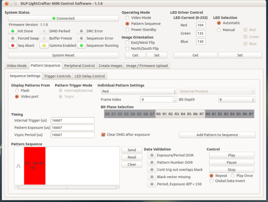

we are currently looking into using the LC4500 in pattern sequence mode. We need it to project without gaps from a parallel RGB input source.
As far as we understand from the current documentation, patterns in "Pattern sequence" mode with "Video port" input, the pattern trigger is controlled with the internal trigger parameter.
1. Since the two 24bit buffers rotate at every vsync, what happens if the vsync period is not a multiple of the internal trigger period?
2. Can we let the vsync be the only trigger that controls pattern sequence start?
3. Is it possible to have LC4500 save all settings between restarts (LC3000 solutions)?
4. With the settings below, we see sporadic flimmer/black frames on the projected image. Is this caused by incorrect settings or by a bug in the firmware?
As a side note, we are impressed with the power of the LC4500, but seeing quite a number of bugs and crashes in the current firmware and gui. We are hoping that TI is working actively to resolve these issues.

    For questions 1&2) Each pattern in the sequence has a trigger type: external positive, external negative, internal, or no trigger. When using the vsync as a trigger, the first pattern in a frame is set to 'external positive', and the next patterns are 'no trigger.'
    1) The internal trigger should be set equal to the vsync period. If the timing for all of the patterns in a frame is less than the vsync/trigger period, you could see a dark image/flicker. If the timing for all of the patterns is greater than the vsync period, the GUI should warn you of an error.
    2) Do you want the the Vsync to only start the pattern sequence and then be ignored? If so, this may not be possible. As the pattern sequence repeats, the first pattern, which is defined as 'external positive', will wait for a vsync. TRIG_IN_2 is a start/stop trigger that could be of use.
    3) Saving solutions will be available in the next GUI release.
    4) Right click on your pattern and uncheck "Clear DMD after exposure". Or, rebuild the pattern sequence, but do not clear the DMD after exposure (the box next to Add Pattern to Sequence).

    thank you for the advice. It seems upon further investigation, that the sporadic black frames are caused by a slightly delayed vsync from my computer. The LC then gets the new frame too late and shows a black frame for about one exposure period.
    In order to fix it, I have to reduce the exposure time by quite a bit ~200usec. This in turn leads to a notably flimmer at all times. That works OK when my camera is triggered and set to the same exposure time, however it does not work well with a software triggered camera.
    By unchecking "Clear DMD after exposure", the sequence check complaints that a "black vector" is missing, so this is, unfortunately, not an option.

    There are two modes for exposure times/trigger periods. The first one is that you need a 230us delay between the two to allow time to clear the DMD.
    However, if you are not clearing the DMD, then you can make the exposure time and trigger period equal.
    On that same note, the "black vector missing" error is a warning (not an error) that the DMD is not being cleared. If your pattern sequence is running, you can choose to ignore this warning.
    In summary, I suggest you try unchecking the "Clear DMD" box and removing the difference between the exposure time and trigger period. If you still see a flicker, then set your trigger period slightly lower than your vsync period. Hopefully this setup will remove the flicker.
