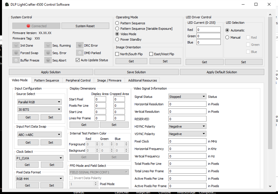

I have TIDA 00293 and need to program it. But first of all I need to check that it is connected properly and operates as intended. I can connect to it using USB cable via LightCrafter program (see LightCrafter.png) and turn LEDs on/off.

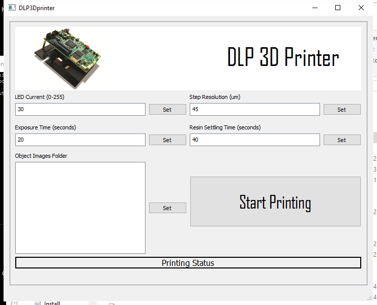

However when using PrinterGUI software the USB cable alone is not sufficient and TTL-232R-3V3 cable is needed with the FTDI chip to launch the software (PrinterGUI.png).
Unfortunately I cannot set the image with this program although it does not show any error messages (via USB cable the original firmware image is reset to the the blank screen). When I disconnect the TTL-232R-3V3 from TIDA 00293 I get exactly the same result. Therefore I made a conclusion that both, the USB cable and the TTL-232R-3V3 cable are involved in the data transfer and it is not clear how exactly it works. The connection I used for TTL-232R-3V3 cable to J25 pins in the TIDA 00293 with the following sequence: GND->GND, RXD->TDI, TXD->TMS1.

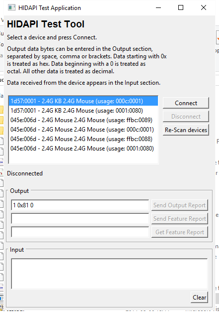

I've checked also with another tool the HIDAPI Test tool (HIDAPI Test tool.png, don't mind the missing device because it was not connected when I've made the screenshot).
I am able to connect to the TIDA 00293 using USB cable but when I send the output or the feature report I always get the parameter size is incorrect (although I've use the examples which must have replied with the correct answer).
