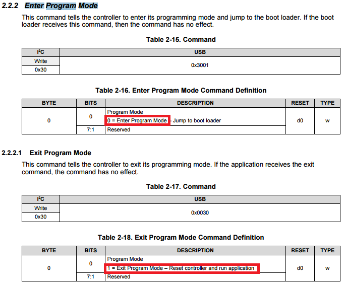

I have questions about the Program mode commands for DLPC900.
DLPC900 Programmer's Guide(dlpu018b) is described that the set value of Enter Program Mode is "0" and Exit Program Mode is "1".
However, after a review of the actual packet, it seems that the set value of Enter Proram Mode is "1" and Exit Pogram Mode is "2".
Is the description of the document correct?
