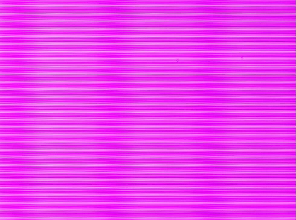

    Thank you for your reply. Yes, I get a new unit with UV light (Actually only blue light works) from Wintech (TI DLP Pro4500). They told me it is same with lightcrafter and with same user's guide. I learn it from the guide and the video from TI.

    First, I choose red light, Flash index 1, R7, pat exposure/period 500000 and then add pattern to sequence.
    Second, choose green light, Flash index 2, B7, pat exposure/period 2000000 and then add pattern to sequence.
    Third, click send and click save solution as custom.ini.
    Then, Browse the firmware file (DLPR350PROM_v3.0.0.bin), select the custom.ini, and use monochrome(Blue channel).
    Add the Firmware Tag as custom_001 and save updates as custom_001.bin
    Last, upload custom_001.bin. But the result is different.
    Video_image:
    my unit_image from a CCD camera:
    I don't understand why it is different.  I don't know what's wrong or missing.

    I figure out this problem. I bought the unit without the foucing lens and the problem of diffraction shows. Right?

    That being said, if there is only one color of LED (blue), trying to display green or red will probably not work, you will only get the blue bit-planes. I hope that makes sense.
