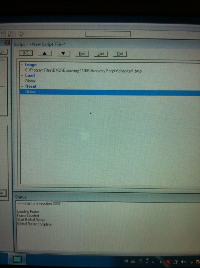

    Thanks for your reply and I sucessfully communicated with Discovery1100. But when I try to send command to it, there is no pattern on DMD.
    Here is the script I used to control the Discovery1100. Is there anything wrong?
    Thank you,
    Enid
  • Enid,
    This looks correct. You should have and image in memory, then load, and then reset. Since you chose global, this should work. Do the mirrors change from the unpowered state (i.e. all "on")? Or do they not change at all. Try adding a wait and then send a clear command. Do the mirrors change state (to "off")?
    However, this looks like the Discovery 4100 Interface. I can't remember what the Discovery 1100 interface looked like. What does the Window title bar show? It is not shown in your picture.
    If it is the 4100 Explorer, it will not work with the D1100 drivers. If it is the 1100 Explorer interface, then I do not know why. Is this the original DMD that came with the kit? Also go to the DMD control section and set the invert (or "comp") bit and run the script again and see if the mirrors are in a different state.
