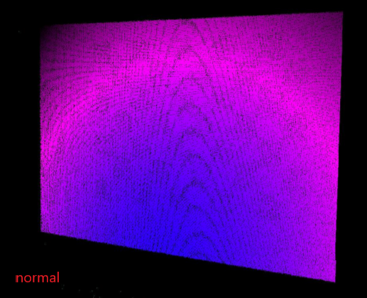

I Follow (http://www.ti.com/lit/ug/dlpu019b/dlpu019b.pdf) till page 50
but my point could result was terrible,(all detail setting is same as user"s guide)please help me

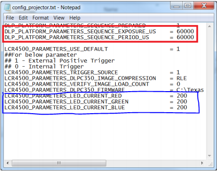

    Can you increase the brightness of the projector? or Increase the camera aperture to make image look brigter? For projector brightness you can increase it by changing the brightness values
    http://www.ti.com/lit/ug/dlpu019b/dlpu019b.pdf Figure Figure 3-4. Projector Exposure Settings for Vertical and Horizontal Three-phase Scanning
    Can you just try one option? Horizontal scan or Vertical Scan alone,
    I.e Option 6 or Option 7
    Sanjeev
  • Hi~
    my  (Horizontal scan) and (Vertical Scan) is better than (Horizontal and Vertical Scan),
    but point could maps still can't be recognize as a piece of paper,
    i had tried to change the brightness values but it's not helpful
    i can't figure out what may be the problem...
    I suggest you increase the LED_CURRENT futher - looks like you changed from 200,200,200 to 50,50,50. Can you try other way, 300,300,300.
