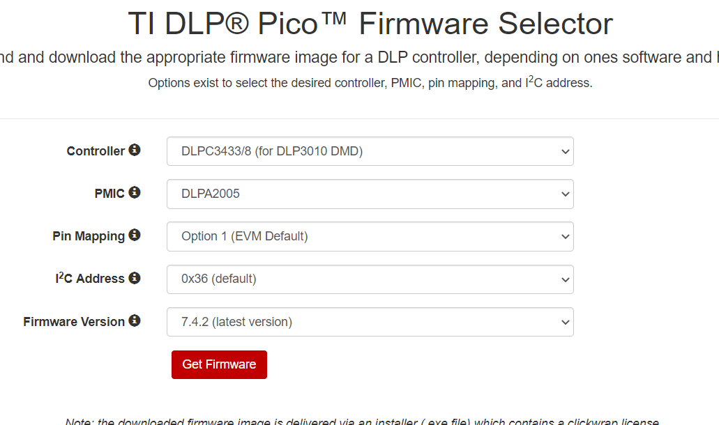

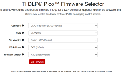

    1. Have you performed a flash verify on the device currently installed to your board?
    => Yes. We have the vefify when burn the firmware into into the flash.
    2. have you confirmed that the flash contains the correct binary image information installed to your system?
    =>The chips of our board are  DLPC3438CZEZ + DLPA2005(silkscreen:PAD2005) + DLP3010. And the formware is the "FWSel_DLPC3433_DLPA2005_pm1_i2c0x36_v7p4p2.img" from http://software-dl.ti.com/dlp/pico-fw-selector/.
    So,  What circuits do we need to test for fix this issure yet?
    Thanks.
    Best Regards.
    hui
