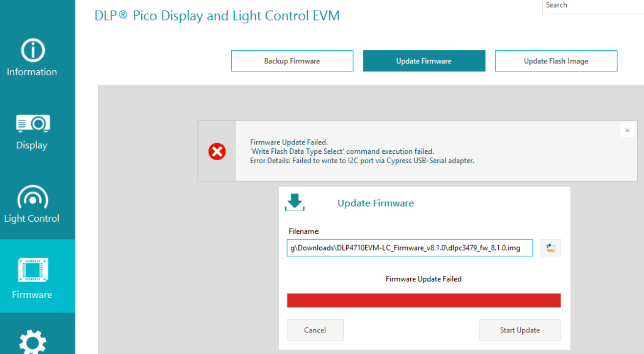

Dear Mayank,

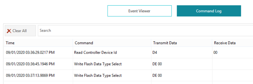

When I use the GUI tool to flash the DLPC controller firmware, error message is pop out and the flash firmware process cannot be done.
At the event viewer it shown as below.
At the command log it shown as below.
What can i do to flash the DLPC controller board firmware?

Weng Yeong,
Please try flashing the firmware by keeping the switch in the off position and not in the on position. If the issue is due to firmware corruption, then this should address it. If it doesn't, then kindly install the GUI again and try doing the same.
Still, if the issue is not addressed, then I believe there is some problem with the hardware.
