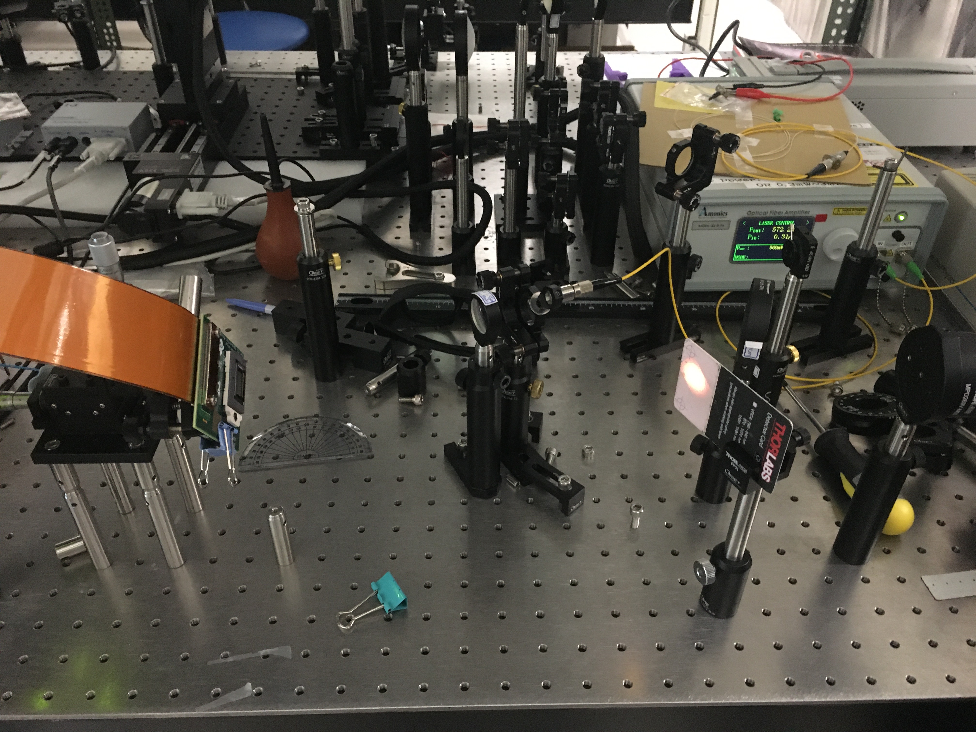

         I am very sorry for this late reply, as we were trying all sorts of possible solutions we could think of. Unfortunately, they are all of no use. Please see the attached picture, this shows the illumination system we are currently using.
    While keeping the window is rotated by 45° and illuminate the DMD at 24° with respect to the window normal, we examine the reflected image on an IR card.
    For your reference, the image we showed on DMD is this "Number 9".
    However, from our experiment, we still observe some interference on the reflected pattern. As shown as following image.
    While we have tried our best to satisfy the illumination requirement of DMD, we are unsure where does this non-ideal effect come from. Could you provide some comments on this?
    Sorry again for the late response, and thank you for your patience in advance!

          The following are the images that failed to show in the previous reply. First is the illumination optics.
    Second is the "Number 9" we observed on IR card.

    I work with Gary and have experience with DMD diffraction issues.  I have a some questions.  I am looking at the resulting "9" image on the IR card.  How does this differ from what you are expecting to see?
    Is the power in the output significantly lower than expected ?  If so how much?
    Have you tried putting an IR lens on the output to re-image the surface of the DMD onto the card?  Also, what wavelength of IR are you using?
