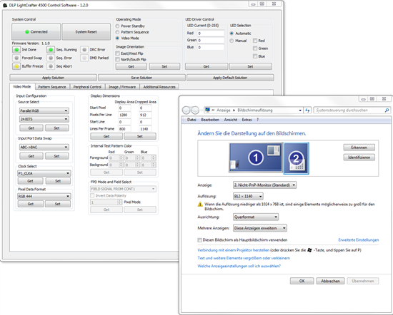

With my Nvidia setup, I tried the work-around proposed by in this thread (changing the registry to enforce display detection). With that workaround it worked for some hours, before it stopped for no obvious reason. When I try to stream video, the LightCrafter continues to display what has been set latest (e.g., an internal test pattern). In the GUI I selected Parallel RGB and 24bit. The "Buffer Freeze" is yellow all the time in video mode. I also tried to adjust the "display dimensions" box. When I set the native 912*1140, it gets back 912*800, or sometimes 1200*800, however, the adjustment has no visible effect. Pattern sequence mode with images from flash still works, but with external patterns from video input nothing is displayed. I'm using a new HDMI to mini-HDMI cable, I tried also combinations with a DVI to HDMI adapter, but with no luck.
What does the buffer freeze mean? What can I do to enable the detection through HDMI? Is there a comparable Solution (updating the EDID) as mentioned in the linked thread?

    It sounds like you have your LightCrafter 4500 setup correctly. Could you send me a screenshot of your computers resolution settings? I wonder if the computer's resolution settings are incorrect. They should also be set to 912x1140.

    the problem is that the projector is not detected at all, so there is no resolution I can adjust besides the one of my main screen. Sorry german screenshots only, I cant change the language by myself now.
    However, using the registry modification described in the other thread one can force the graphic card to assume there is another display. Then another non-defined display appears:
    Its resolution was set manually by myself via the Nvidia control panel. With that, at least video mode worked properly (timing in pattern mode seemed to fail). In video mode I could even adjust other resolutions than the native one. But it worked only for a few hours and stopped doing so without an obvious modification from my side. It appears that the registry modification was not a very stable solution, and at the moment it's not a solution at all. However, because it worked for a while at least the cable or adapter seems not to be a problem.
